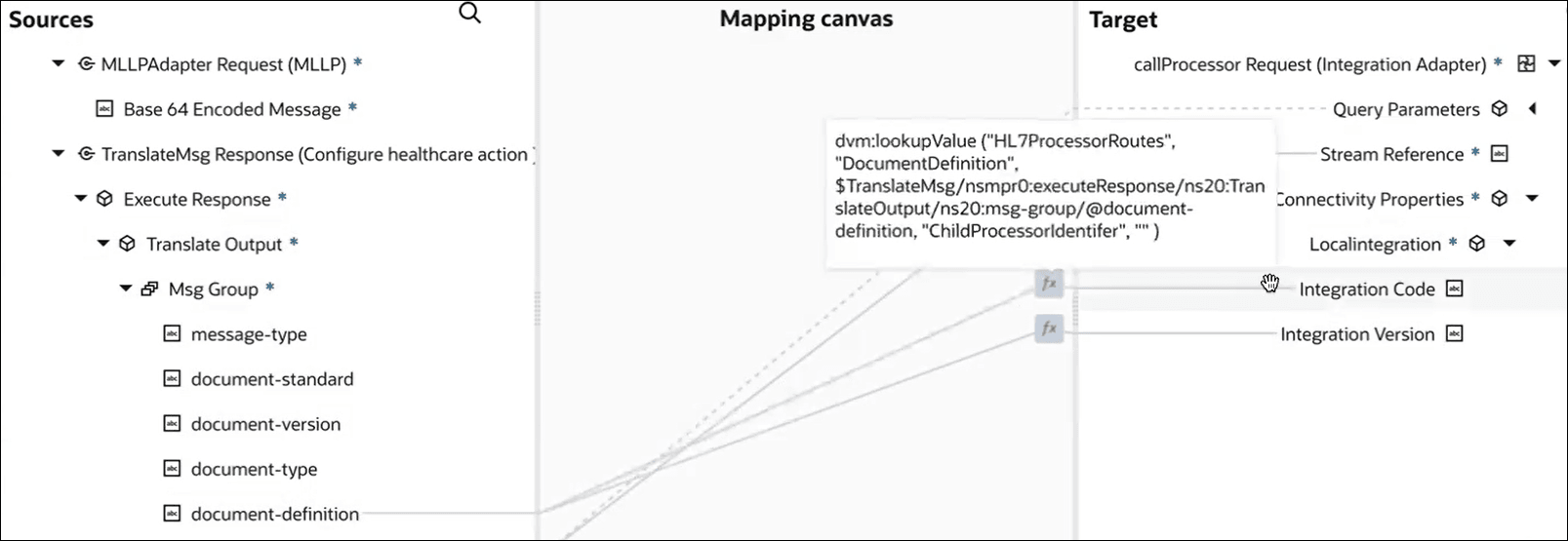

Use a lookup function in the mapper to select the child integration to invoke. Based on the message and message type, the lookup function returns the name of the integration (Integration Code) and the version of the integration (Integration Version) to invoke.
The Sources, Mapping canvas, and Target sections of the mapper are shown. The target Integration Code is selected to show the lookup value function code that is being called.

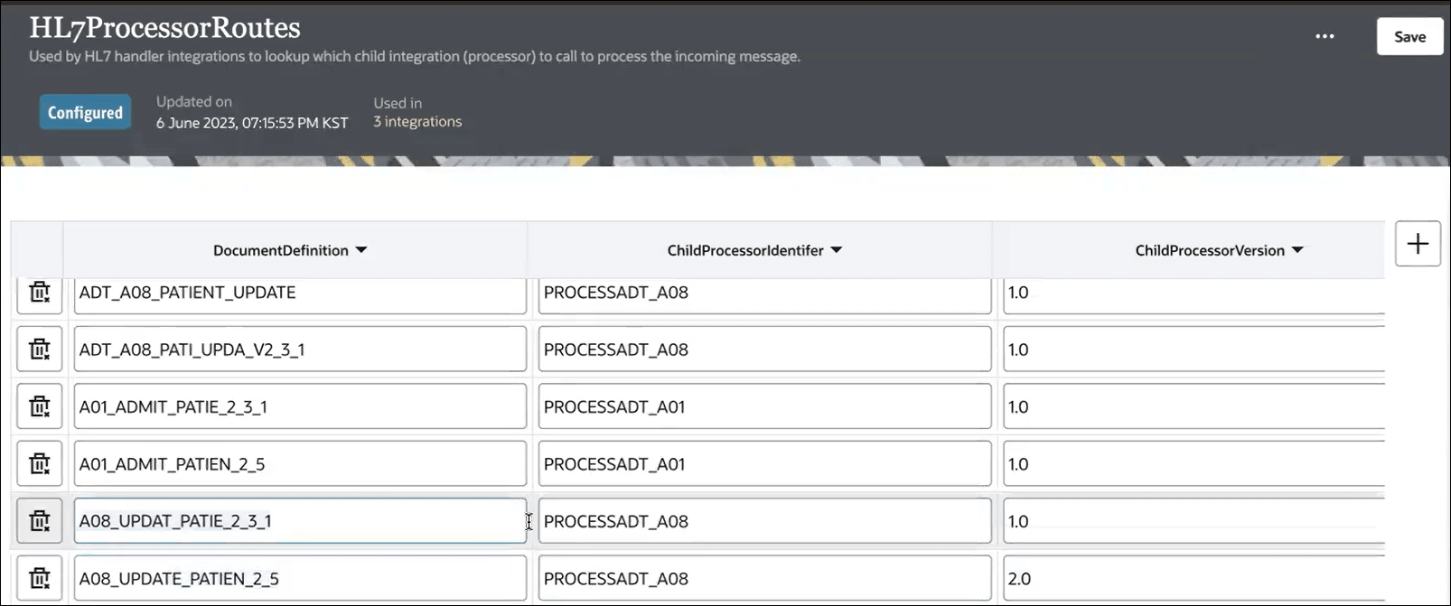

In the lookup table, based on the specific inbound message received, a specific integration is invoked.
The Lookup table shows columns for deleting the lookup, the DocumentDefinition, the ChildProcessorIdentifier, and the ChildProcessorVersion. The Save button appears in the upper right corner. A plus sign appears at the far right of the table.

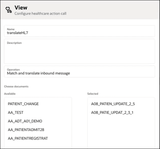

In the healthcare action, you select the following two inbound message types for translation:
  • ADT_A08 (Update patient information) version 2.5
  • ADT_A08 (Update patient information) version 2.3.1
The healthcare action dialog shows a Name field, Description field, Operation field, and Choose messages section, which includes the Available field and Selected field. Two documents have been selected: ADT_A08 version 2.5 and ADT_A08 version 2.3.1.
Assume the healthcare action also receives an inbound ADT_A04 (Register a patient) message from the HL7 application. Because this message type has not been selected in the healthcare action, it cannot be translated into an Oracle Integration payload. The ADT_A04 message type is passed through the healthcare action, but fails in the subsequent map action with errors.

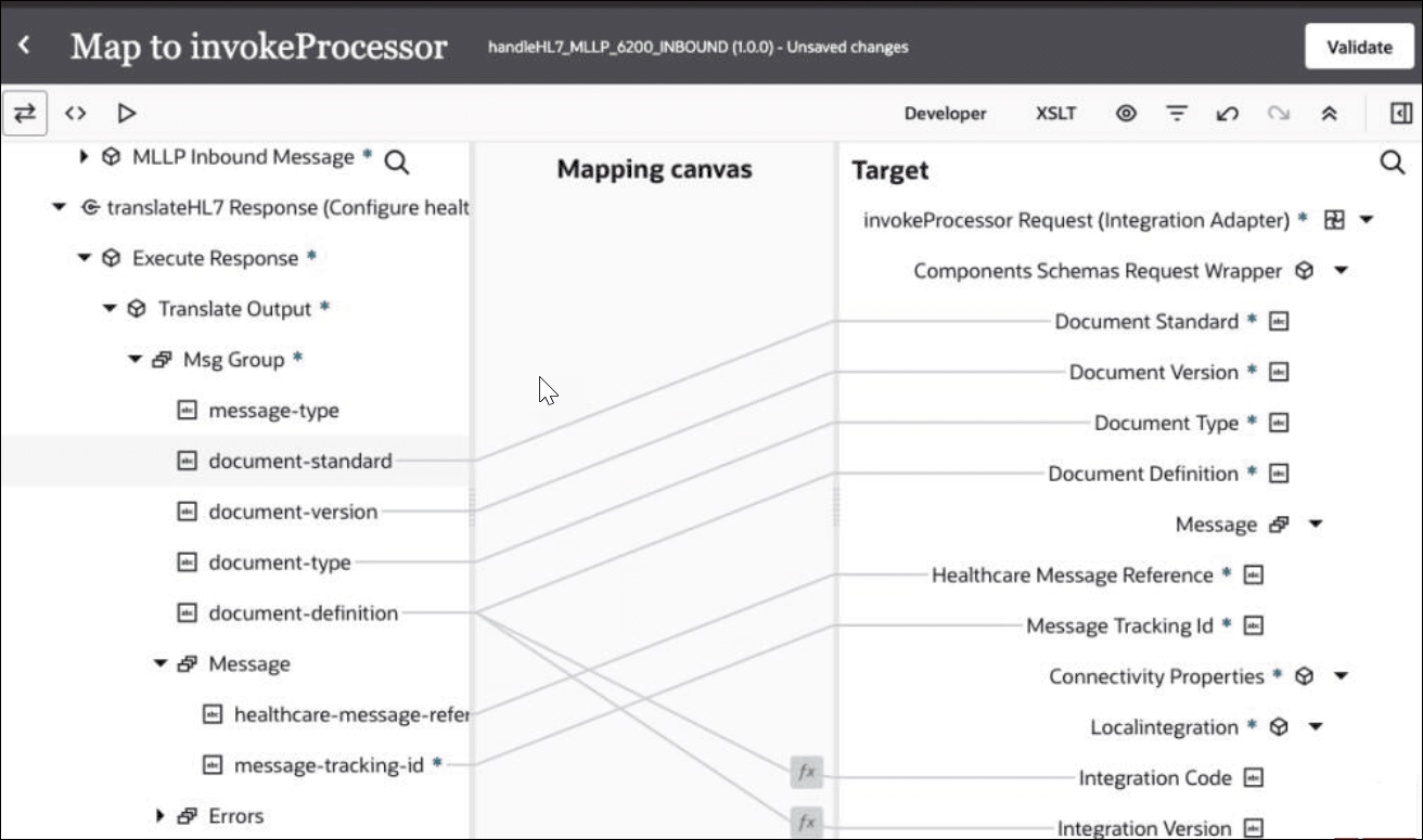

Use of this JSON message in your child integrations is not required. However, use of this message enables you to take advantage of potential future features. The idea is that if you use this JSON message as the contract in your child integrations now, change are not required in the future. You do not need to create a new handler integration. The incoming HL7 message is routed to the appropriate processor integration based on your routing rules. For this to work, you need to build your integration using this JSON payload.
This payload provides metadata about the message and capability to also support batch messages. You map this data using the data returned from the healthcare action when you call the operation Match and translate inbound message. An example of this mapping is shown below.
