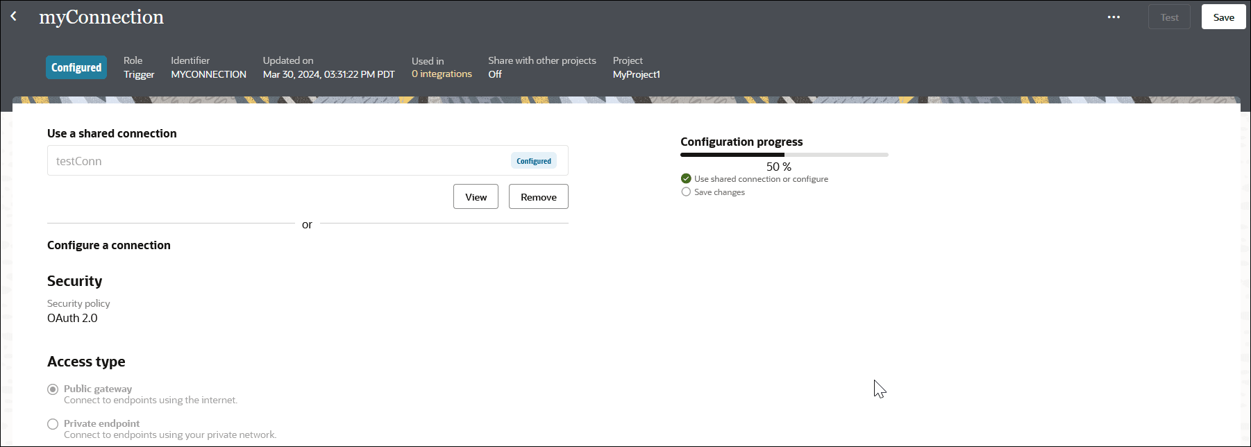

- Open a different project to create the local connection.
- Create a connection of the same adapter type (REST Adapter) and same role (Trigger) to match
the publicly available adapter.
The Connections page is displayed. Note the Use a shared connection field at the top.
- Enter a letter that is part of the name of the publicly available
connection (for this example,
tis entered).A filtered list of connections is returned that shows only publicly available connections of the same adapter type (REST Adapter) and same role (Trigger) that include that letter.
- Select the publicly available connection (for this example, testConn). If the project of the publicly available connection is configured with role-based access control (RBAC) settings, you must have at least view permissions in that project.
- Click Save.
The local connection automatically references the connection configuration settings of the publicly available connection.
- Save the connection, then exit the Connections page.
The connection is displayed as Configured in the project. The Override label is displayed, meaning this connection references the resources of the publicly available connection.

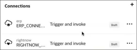

- Create a local connection and leave it in a draft state (for
this example, the connection is named
RIGHTNOW_CONN).

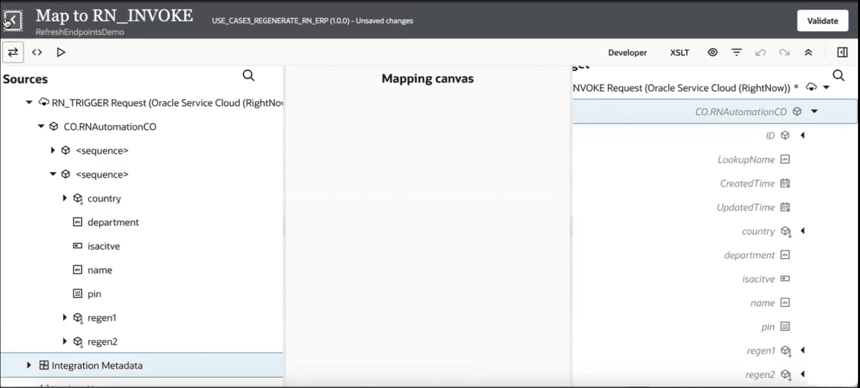

- Go to the integration canvas and view the map action for the
connection. This shows the contents of the mapper prior to endpoint
refreshing. Note that there are source and target elements named
regen 1 and regen 2.

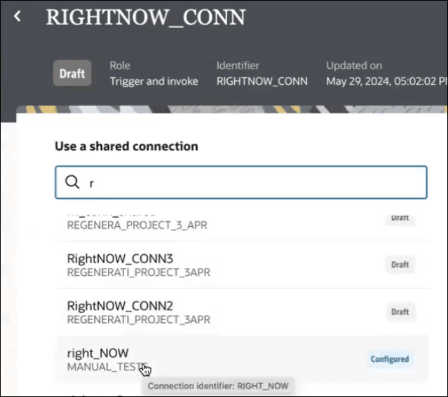

- Return to the Connections section and open the connection (RIGHTNOW_CONN) for editing.
- In the Use a shared connection field,
enter the beginning letter to filter the list, and select the shared
connection to use (for this example, named
right_NOW).

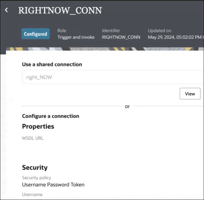

- Save the connection.
The connection state is changed to configured.

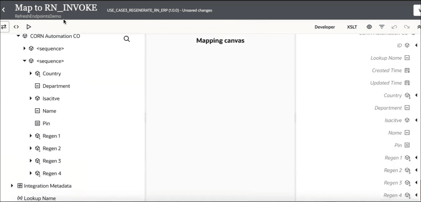

- Select the connection to refresh (RIGHTNOW_CONN), then click Refresh.
- Wait for the refresh to complete.
- Return to the mapper for the connection. Note that there are now
source and target elements named Regen 1,
Regen 2, Regen 3, and
Regen 4.
