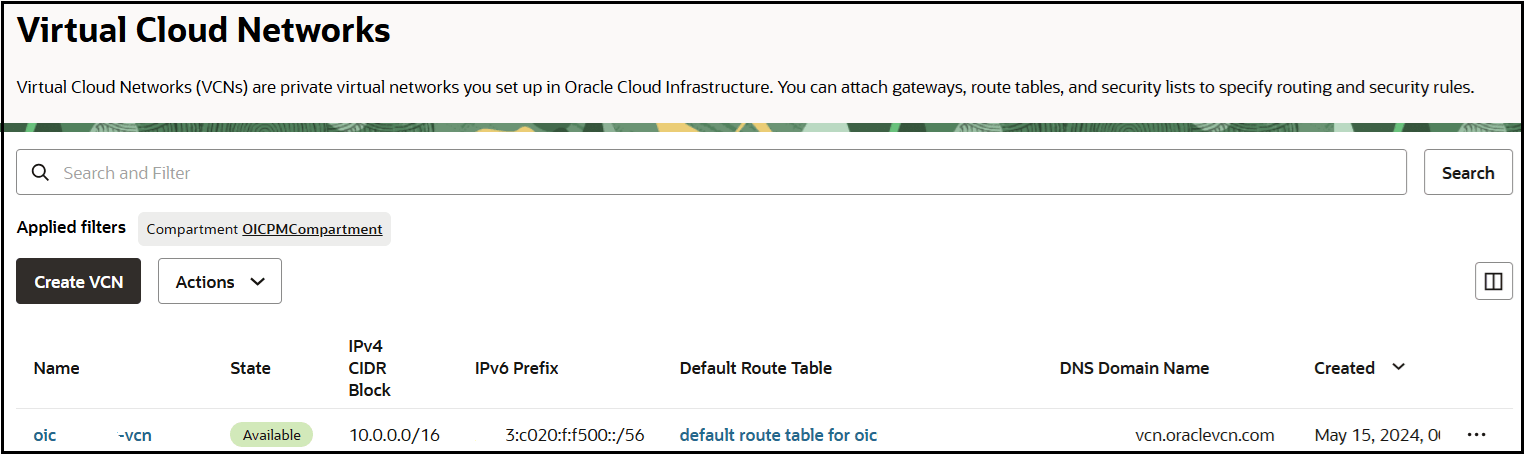

      • Create a virtual cloud network (VCN) and subnets. For example:
        The Virtual Cloud Networks page is shown. At the top is the compartment name. Below are the Create VCN and Actions buttons. Below is a table with columns for Name, Status, IPv4 CIDR Block, IPv6 Prefix, Default Route Table, DNS Domain Name, and Created.

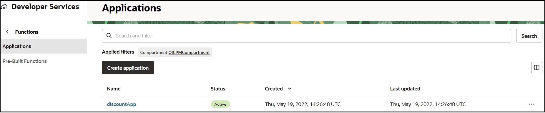

    • Create an application in which to create the functions to invoke. You specify this application when configuring the OCI Function action in the integration canvas. For example:
      The Applications tab is selected in the left navigation pane. At the top is the label Applications. The compartment name appears below. Below is a table with columns for Name, Status, Created, and Last updated.

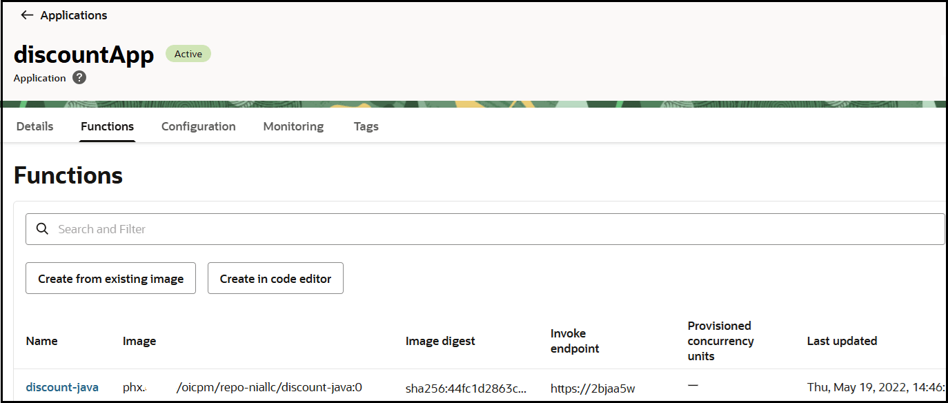

    • Create, deploy, and invoke your function. For example:
      You must create your own functions in your tenancy. Oracle Cloud Infrastructure doesn't deploy or create any functions for you by default. Oracle Cloud Infrastructure does provide prebuilt functions that you can deploy to your own instance.
      The Functions page is shown. At the top of the page are the Details, Functions, Configuration, Monitoring, and Tags tabs. Below this are the search field, the Create from existing image link, and Create in code editor link. Below is a table with columns for Name, Image, Image digest, Invoke endpoint, Provisioned concurrency units, and Last updated columns.

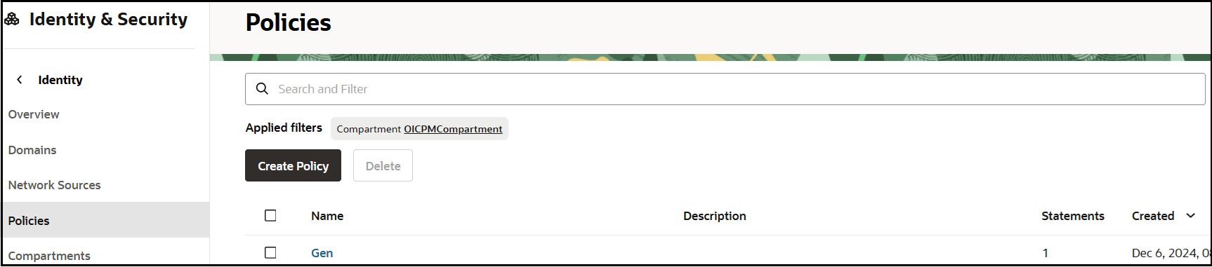

  8. In the left navigation pane, click Policies to assign a policy to the dynamic group to enable you to invoke Oracle Cloud Infrastructure functions from an integration.
  9. Click Create Policy.
  10. Enter the following details:
    1. In the Name and Description fields, enter values. These fields are required.
    2. In the Policy Builder section, click Show manual editor to build the required policy for the dynamic group. The following example allows the dynamic group to use the entire functions family, but you can set more granular policies, as needed. See Controlling Access to Invoke and Manage Functions and Policy Statements to Give OCI Functions Users Access to Function-Related Resources.
      Allow dynamic-group group_name to use functions-family in compartment compartment_name
      Where:
      • group_name: Is the dynamic group name you created.
      • compartment_name: Is the compartment where the functions to invoke are hosted.
      If you are not creating the policy in the default domain, then specify your domain name in front of the group name. For example:
      Allow dynamic-group identity_domain/group_name to use functions-family in compartment compartment_name
      This enables the Oracle Integration instance associated with the dynamic group to invoke Oracle Cloud Infrastructure functions with the OCI Function action in an integration.

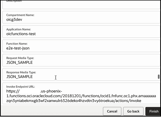

  5. Review your selections on the Summary page. For this example, the hello-python-json function is invoked. The request and response media is in JSON format.
    The Basic Info page shows the wizard train at the top: Basic Info, Request, Response, and Summary. To the left and right of the train are < and > links, respectively. Below are the values for the Compartment Name, Application Name, Function Name, Request Media Type, Response Media Type, and Invoke Endpoint URL.

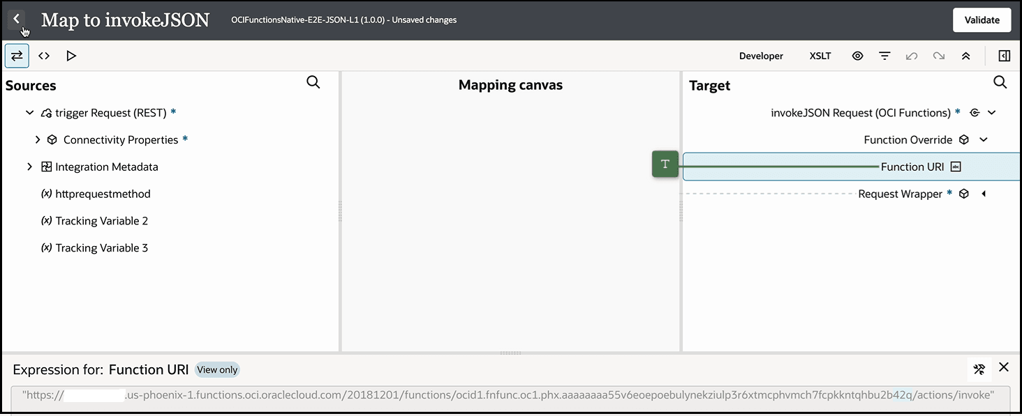

Override the Endpoint URL Setting for the OCI Function Action at Runtime
You can specify the invoke endpoint URL to use at runtime in the mapper. This setting overrides the invoke endpoint URL specified in the OCI Function action at design time.
The following steps provide an overview of configuring this feature:
  1. Configure the OCI Function action. The Invoke Endpoint URL field on the Summary page shows the URL specified.
    The Summary page shows the Description, Compartment Name, Application Name, Function Name, Request Media Type, Response Media Type, and Invoke Endpoint URL fields.

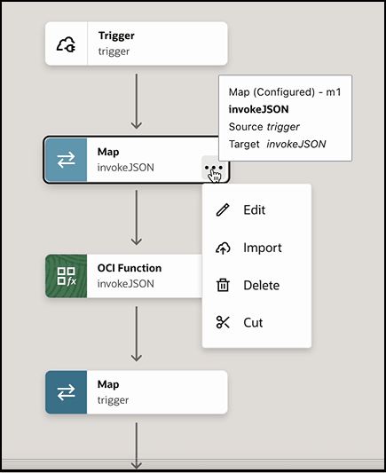

  2. Open the mapper for editing.
    The integration shows trigger, map, OIC Function, and map actions. The first map action is selected to show options for Edit, Import, Delete, and Cut.
  3. Expand the target Function Override element.
  4. Right-click Function URI and select Create target node.
  5. Enter the endpoint URL in the Expression Builder. This value overrides the value configured in the OCI Function action for the Invoke Endpoint URL field.
    The Sources, Mapping canvas, and Target sections of the mapper are shown. The target Function URI element is selected to show the value specified in the Expression Builder.
  6. Complete integration design, then activate and run the integration.

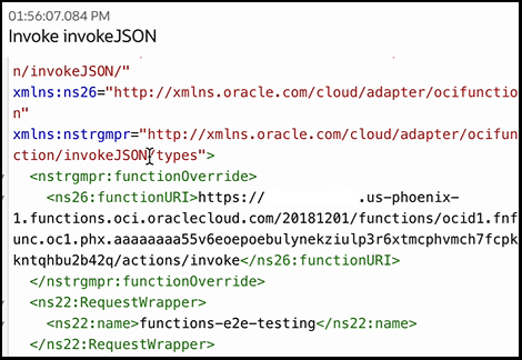

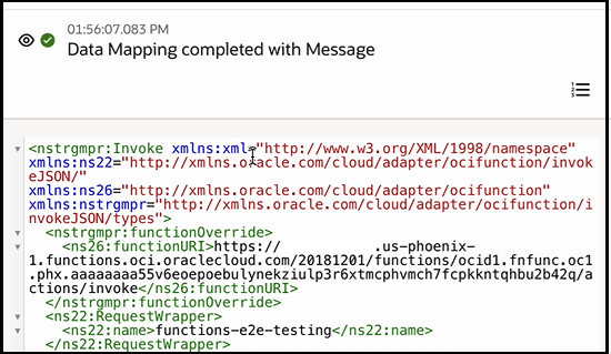

  7. View the mapper in the activity stream and note that the function URL specified in the mapper was used.
    The activity stream for the mapper is expanded to show the functionOverride element. The value shown is the one specified in the mapper.
  8. Expand the invoke connection for the OCI function action in the activity stream and note that the function URL provided in the mapper was also used.
    The activity stream for the OCI function action is expanded to show the functionOverride element. The value shown is the one specified in the mapper.
