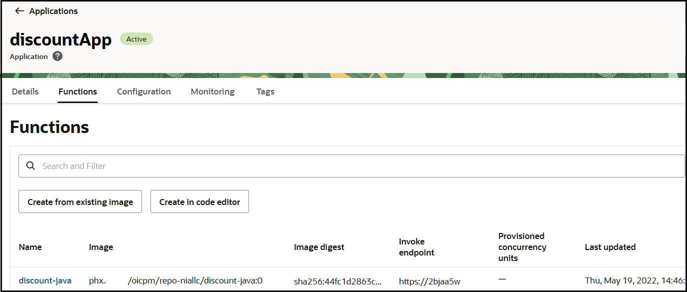

    • Create, deploy, and invoke your function. For example:
      You must create your own functions in your tenancy. Oracle Cloud Infrastructure doesn't deploy or create any functions for you by default. Oracle Cloud Infrastructure does provide prebuilt functions that you can deploy to your own instance.
      The Functions page is shown. At the top of the page are the Details, Functions, Configuration, Monitoring, and Tags tabs. Below this are the search field, the Create from existing image link, and Create in code editor link. Below is a table with columns for Name, Image, Image digest, Invoke endpoint, Provisioned concurrency units, and Last updated columns.

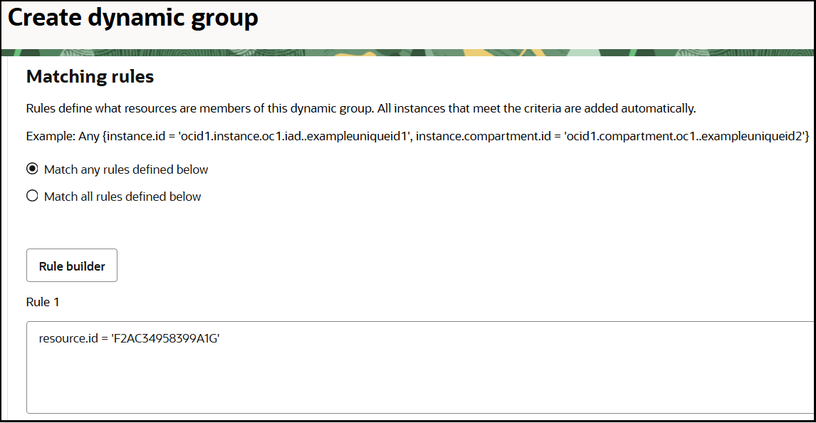

  7. Enter the following details:
    1. In the Name and Description fields, enter values. These fields are required.
    2. In the Matching Rules section, enter the required rule. The resource ID you specify must match the client ID of the OAuth application of your Oracle Integration instance. Ensure that you enclose the value in single quotes. For example:
      resource.id = 'client_ID'
      The Create dynamic group page is shown. Below this is the Matching rules section, with example text and radio buttons for Match any rules defined below and Match all rules defined below. Below this is the Rule builder link. The Rule 1 section shows the resource.id parameter and value.

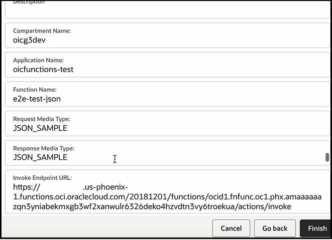

  1. Configure the OCI Function action. The Invoke Endpoint URL field on the Summary page shows the URL specified.
    The Summary page shows the Description, Compartment Name, Application Name, Function Name, Request Media Type, Response Media Type, and Invoke Endpoint URL fields.

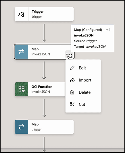

  2. Open the mapper for editing.
    The integration shows trigger, map, OIC Function, and map actions. The first map action is selected to show options for Edit, Import, Delete, and Cut.

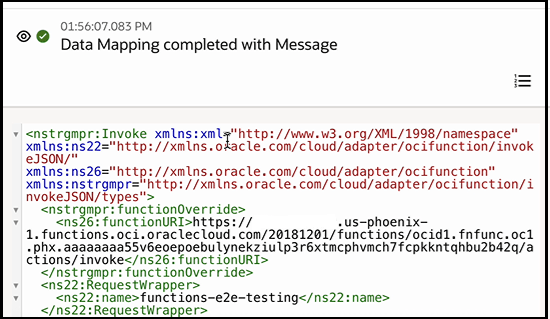

  7. View the mapper in the activity stream and note that the function URL specified in the mapper was used.
    The activity stream for the mapper is expanded to show the functionOverride element. The value shown is the one specified in the mapper.

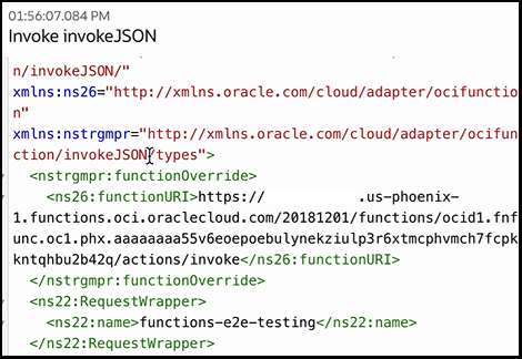

  8. Expand the invoke connection for the OCI function action in the activity stream and note that the function URL provided in the mapper was also used.
    The activity stream for the OCI function action is expanded to show the functionOverride element. The value shown is the one specified in the mapper.
