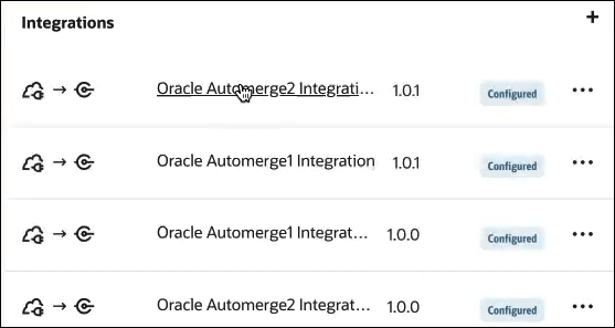

  4. In the Integrations section, find the specific integration to extend.
  5. Click Actions Actions icon, and select Extend. The Extend option is only available in accelerator projects. This option behaves similar to the Edit option in non-accelerator integrations.

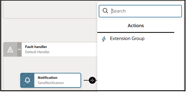

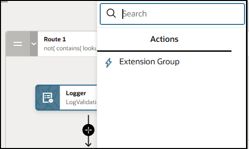

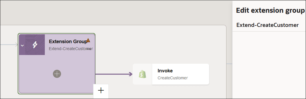

  6. Perform one of the following actions before or after an invoke action or a robotic process automation action.
    1. Click Add Add icon at the location where you want to add the extension, then select Extension Group.
    or
    1. Click Actions Actions icon inside the invoke action or the robotic process automation action.
    2. Based on where you want to place the extension, select Extend before or Extend after. Both options are available if you have not yet added an extension to either side of the invoke action or the robotic process automation action.
      The Invoke action is selected to show options for View, Extend before, and Extend after.
      If Extend before and Extend after are not available for selection and you have not added an extension to either side of the invoke, your administrator has restricted the use of extensions on the invoke connection. You cannot extend restricted invokes.

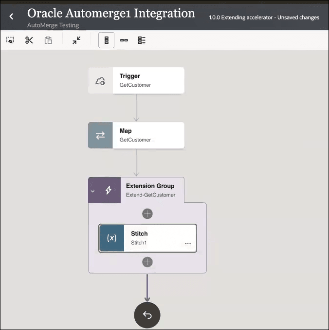

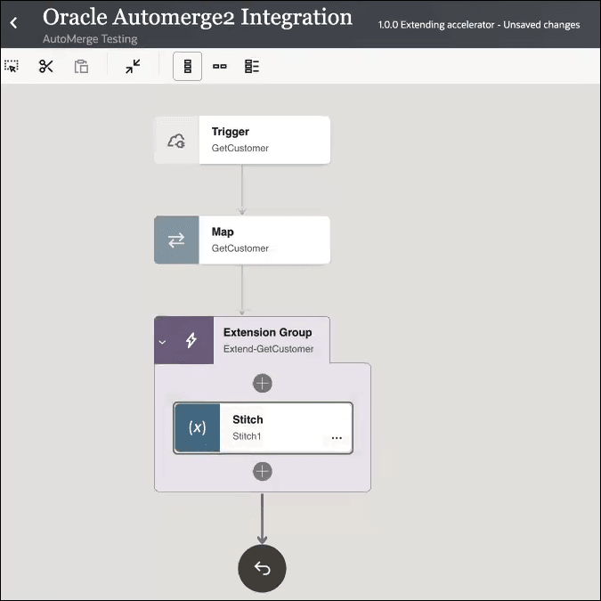

    The extension group is added to the integration.
    The integration canvas shows eight icons at the top. Below is an integration with a scope, map, extension group, and invoke.
  7. If you want to update the name, click Edit Edit icon in Edit extension group.
  8. Click Integration actions Integration actions icon and drag an invoke or action into the integration or click Add Add icon inside the extension group to add an invoke or action to the integration. For example, if you click Add Add icon, the following menu is displayed.
    The Invokes and Actions tabs are shown. Actions is selected to show the Data stitch, Map, OCI Document Understanding, OCI Vision, For each, Switch, Integration, and Robot flow actions.

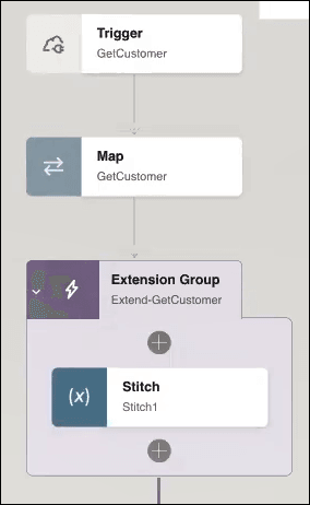

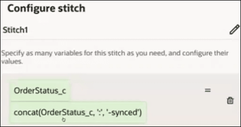

Add a Data Stitch Action to an Extended Integration
You can add a data stitch action to an extended integration. This section provides a use case.

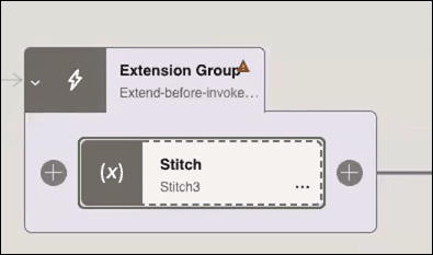

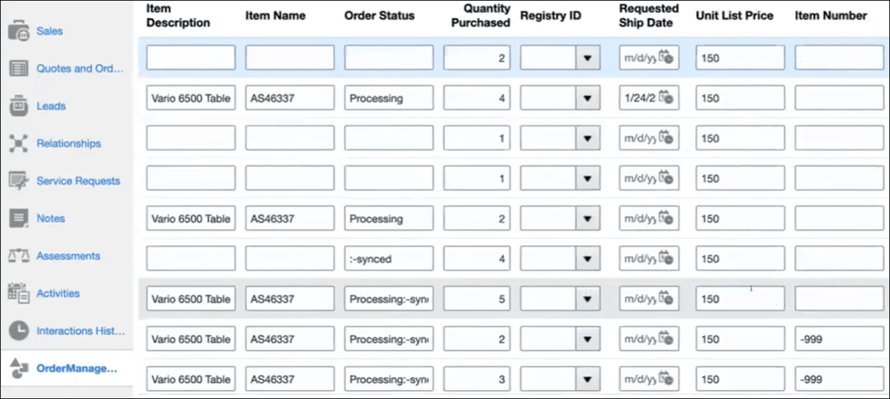

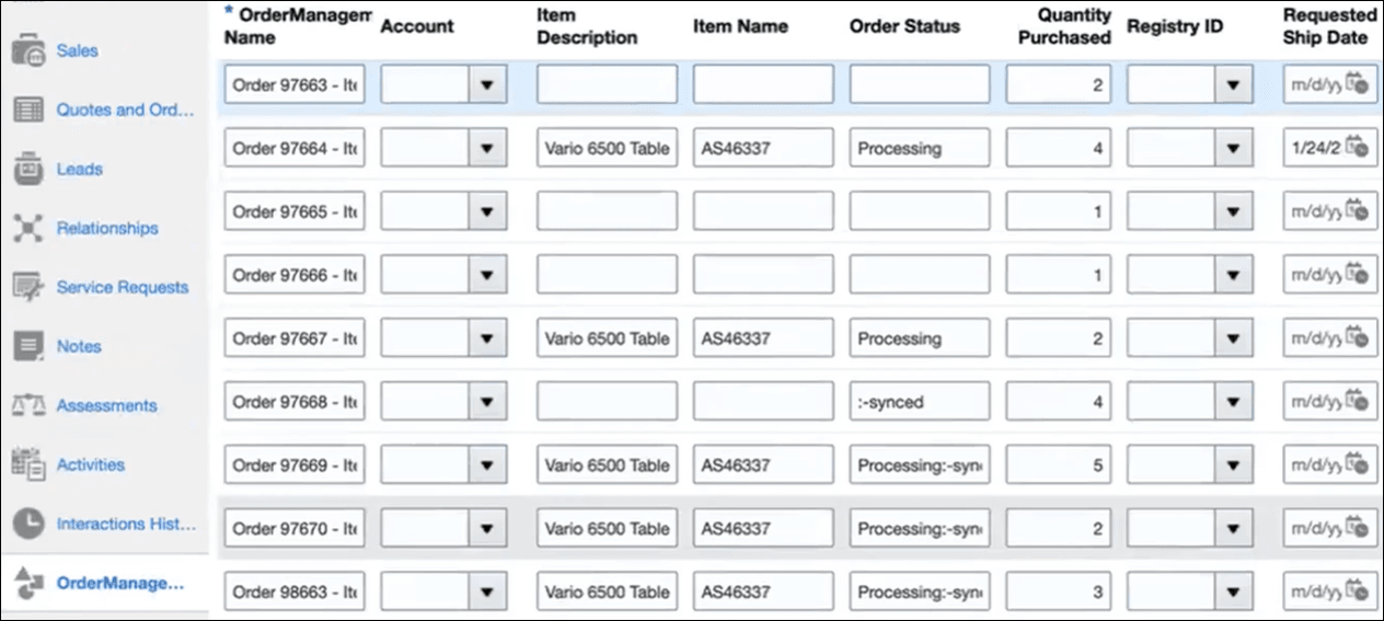

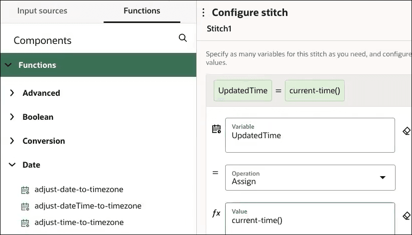

  1. If you select Actions, then Data stitch:
    You can incrementally build a message payload from one or more existing payloads with a data stitch action. For example, a data stitch enables you to customize the sales order created in an inbound application. Assume you have a use case in which whenever a sales order is created in an inbound application, your integration must retrieve and push information in a custom object to an outbound application. In the inbound application, the custom object consists of the following attributes.
    The Order Manager form is selected and includes columns for Oracle Manager Name, Account, Item Description, Item Name, Order Status, Quantity Purchased, Registry ID, and Requested Ship Date.
    The Configure stitch panel opens.
    1. Configure the data stitch. This action enables you to customize the integration with mappings to or from attributes of custom objects. For this example, a data stitch variable is created to process the order status attribute in the custom object.
      The Configure stitch panel is designed to process the Order Status.
      See Build Complex Assignment Statements with a Data Stitch Action.
    2. When integration design is complete, click Save.

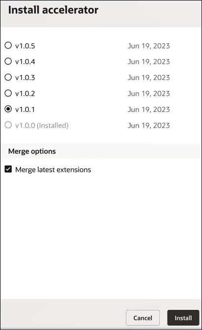

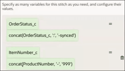

      Assume you later need to further customize the custom objects in the inbound application that triggers your integration. For example, an additional field to handle the Item Number is added to the custom object.
      This use case is not about installing a newer version of the accelerator project available from the Integration Store. Rather, this is an informal user update to the custom objects. You can handle this use case by refreshing the endpoints to pick up the new object and editing the data stitch action to process the new object. You must use a new identifier and/or version. You can also set the name, keywords, and description.
      The Order Manager form is selected and includes columns for Oracle Manager Name, Account, Item Description, Item Name, Order Status, Quantity Purchased, Registry ID, Requested Ship Date, Unit List Price, and Item Number.
  2. Click Actions Actions icon, then select Refresh Endpoints. This action fetches the latest attributes added to the custom object.
  3. Open the data stitch action in the extension group and add the latest custom attribute mapping to the extension group. For this example, a second stitch variable is created to process the item number attribute in the custom object.
    The Configure stitch panel is designed to process the Order Status and the Item Number.

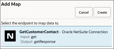

Add an Ad-Hoc Map Action to an Extended Integration
You can add an ad-hoc map to an extended integration.
  1. If you select Actions, then Map:
    The Add Map panel opens to show the endpoints available to which to map. Endpoints both inside and outside the extension group are shown.
    The Add Map dialog shows Cancel and Create buttons. Below is a list of the endpoints that you can select to map data to.
    If there are no endpoints available to which to map, the following message is displayed:
    No outputs available to map to
  2. Select the endpoint, and click Create.

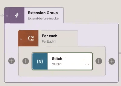

Add a For-Each Action to an Extended Integration
You can add a for-each action to an extended integration.
  1. If you select Actions, then For each:
    A for-each action is added to the Extension Group.
    The Extension Group includes a For each action inside it.

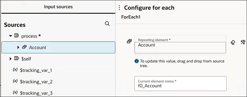

  2. Configure the for-each action. For this example, an Account element is defined as the repeating action.
    The Input sources section appears on the left side. Below it is the Sources section of elements. The Account element is selected. On the right side is the Configure for each section. The Repeating element field as a value of Account and the Current element name field as a value of 10_Account. To icons appear to the right of the Repeating element field.
  3. Perform further configuration, as necessary. For this example, a data stitch action is added. For each iteration of the Account element, a value is updated to the current time.
    The Input sources and Functions (which is selected) tabs are shown. Below is the Functions list, which is expanded to show Advanced, Boolean, Conversion, and Date categories. Date is expanded to display the available functions. On the right is the Configure stitch section. Below this is the configured data stitch action, the Variable field, the Operation list, and the Value field.
    The extension group design looks as follows:
    The Extension Group is shown with a For-each action. Inside the For-each action is a Data Stitch action.

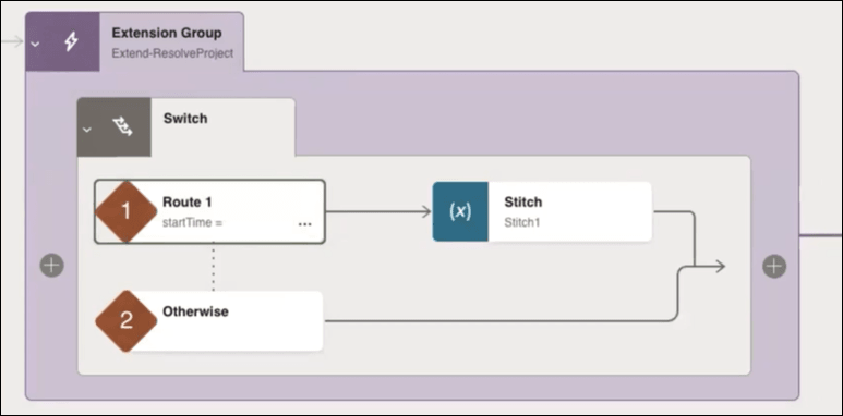

Add a Switch Action to an Extended Integration
You can add a switch action to an extended integration.

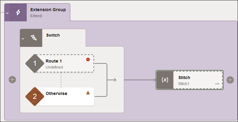

  1. If you select Actions, then Switch:
    A switch action is added to the Extension Group.
    You can add routing expressions in an integration with a switch action.
    The Extension Group shows a switch action with two branches: Route 1 and Otherwise.

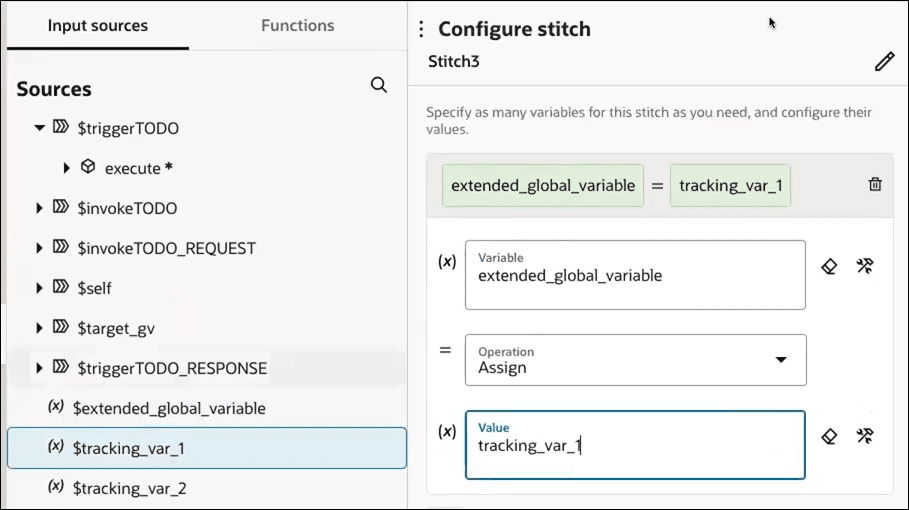

    You can add a data stitch action inside the switch action.
    1. Click Install icon, then select Stitch.
      The Extension Group shows a switch action with two branches: Route 1 and Otherwise. To the right, a data stitch action has been added.
    2. Configure the data stitch action. For example:
      The Configure stitch panel shows an edit icon at the top. Below that is the defined expression. Below that are the Variable, Operation, and Value fields. Each field has Clear and Developer Mode icons.

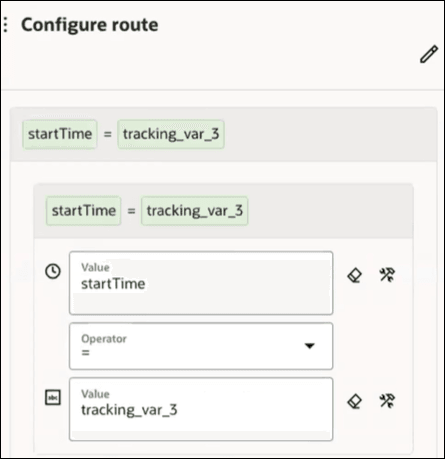

    3. Inside Route 1, click Actions Actions icon, then select Edit.
      The Actions … link of the Route_1 branch is selected to show an option for Edit.
      The Configure route panel opens.
    4. Configure the switch action. For example:
      The Configure route panel shows an edit icon at the top. Below that is the defined expression. Below that are the Value, Operation, and Value fields. Each field has Clear and Developer Mode icons.
      The extended portion of the integration looks as follows.
      The Extension Group shows a switch action with two branches: Route 1 and Otherwise. The Route 1 branch includes a data stitch action.

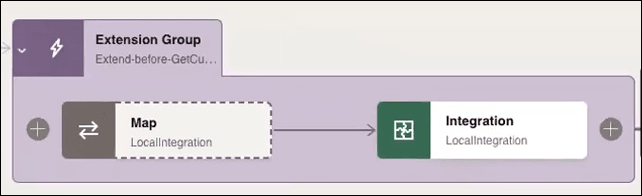

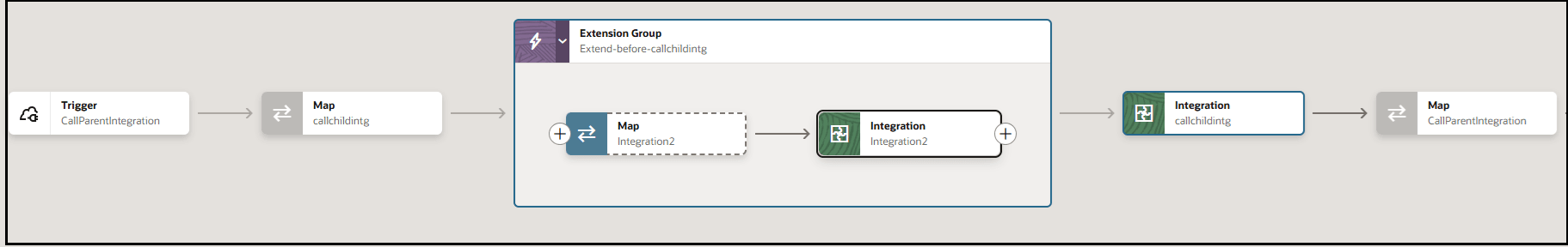

Add an Integration Action to an Extended Integration
You can add an integration action to an extended integration.
  1. If you select Actions, then Integration:
    The Integration Adapter Wizard is displayed.
  2. Click through the pages of the wizard to select the child integration to invoke.
    An integration action and associated map action are added to the Extension Group.
    The Extension Group includes a map and an integration action.

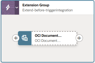

  1. If you select Actions, then OCI Document Understanding:
    An OCI Document Understanding action is added to the Extension Group.
    The Extension Group is shown with a OCI Document Understanding action.

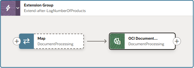

  2. Configure the OCI Document Understanding action. See Invoke Oracle Cloud Infrastructure Document Understanding from an Integration.
    When complete, the map action is created.
    The Extension Group is shown with a OCI Document Understanding action and map action.
  3. Perform specific tasks in the mapper based on the action and input source (inline or object storage) you selected.

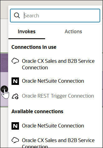

Add an Invoke Connection and Associated Map to an Extended Integration
You can add an invoke connection and associated map to an extended integration.
  1. If you select Invokes, then select an invoke adapter connection:
    The Search field appears at the top. Below are the Invoke and Actions tabs. Invoke is selected to show the available connections.
    The Adapter Endpoint Configuration Wizard is displayed for the selected invoke connection.
  2. Click through the pages of the wizard and configure the invoke connection.
  3. When complete, the configured invoke connection and an associated map action are added to the Extension Group.
    The Extension Group includes a map and an invoke.
  4. Double-click the map action and map appropriate source elements to target elements.

  5. Add an Extension Group to the integration.
  6. Add an action in which to use the extended global variable. For this example, a data stitch action is added.
    The Extension Group includes a data stitch action.
  7. Configure the data stitch action to use the extended global variable.
    The Input sources and Functions (which is selected) tabs are shown. Below is the Sources list. On the right is the Configure stitch section. Below this is the configured data stitch action, the Variable field, the Operation list, and the Value field. The defined stitch value is extended_global_variable = tracking_var_1.

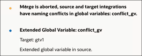

    If there is a naming conflict with global variables (for example, two global variables have the same name), the entire merge is canceled. This cancellation occurs because a global variable can be used in any extension group. For example, if you create an extended global variable named conflict_gv, and a default global variable of the same name already exists, the merge is canceled, and an error is displayed.
    The error shows that the merge was aborted due to naming conflicts.

Extend an Integration Before or After a Log or Notification Action
You can extend an integration before or after a log or notification action. The log or notification action can either be inside of a fault handler or outside of a fault handler.
  1. Perform one of the following actions before or after a log or notification action.
    or
    1. Click Actions Actions icon inside the action and select Extend before or Extend before.
    For example, to add an extension group after a notification action inside a fault handler:
    A fault handler is shown, which includes a notification action. The plus icon after the notification action is clicked to show the Actions menu, with Extension Group as the only selection. A Search field appears above the Actions menu.
    Or before a log action outside a fault handler:
    A Route 1 branch is shown, which includes a logger action. The plus icon after the logger action is clicked to show the Actions menu, with Extension Group as the only selection. A Search field appears above the Actions menu.
    An extension group is added to the integration.
  2. Add the appropriate action in the extension group:
Add an Extension Group Before or After a Parent Integration that Invokes a Child integration
You can add an extension group before or after a parent integration that invokes a child integration.
  1. In the Integrations section, find the specific parent integration to extend.
  2. Click Actions Actions icon, and select Extend. The Extend option is only available in accelerator projects. This option behaves similar to the Edit option in non-accelerator integrations.
  3. Perform one of the following actions before or after the integration action.
    1. Click Add Add icon before or after the integration action, then select Extension Group.
    or
    1. Click Actions Actions icon inside the integration action and select Extend before or Extend after.
      The integration shows a trigger, map action, extension group, integration action, and map action.
  4. Click Create Model iconand select the action to extend the integration.
    For this example, an active integration action is selected and configured in the extension group in front of the integration action.
    The integration shows a trigger, map action, extension group with map and integration actions, integration action, and map action.

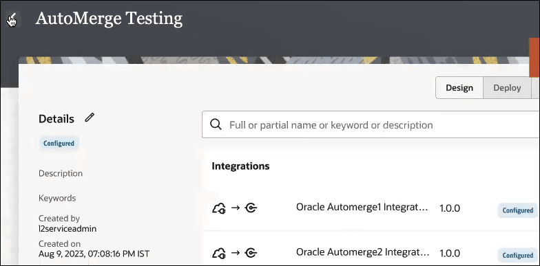

Assume you have an accelerator project that includes two integrations on version 1.0.0.
The search field appears at the top. The Integrations section shows the integration, a calendar icon, version, the current state (Configured) and an Actions menu. An Add button appears above.
Both integrations include an extension group with a stitch action that you added.
Oracle Automerge1 Integration Oracle Automerge2 Integration
The integration shows a trigger, map, and extension group that includes a stitch action.

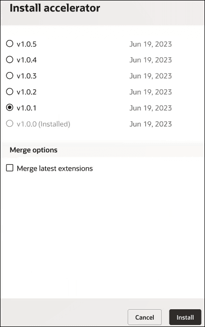

    The Install accelerator panel opens and shows the latest accelerator versions to which you can upgrade.
  3. Select the version to which to upgrade (for this example, v1.0.1 is selected).
  4. If you want to merge the extensions you added (for this example, the stitch actions you added to both version 1.0.0 integrations), then click Merge latest extensions.
  5. Click Install.
    The Install accelerator panel shows the accelerator versions available for installation. The v1.0.1 version is selected. In the Merge options section, the Merge latest extensions check box is selected.

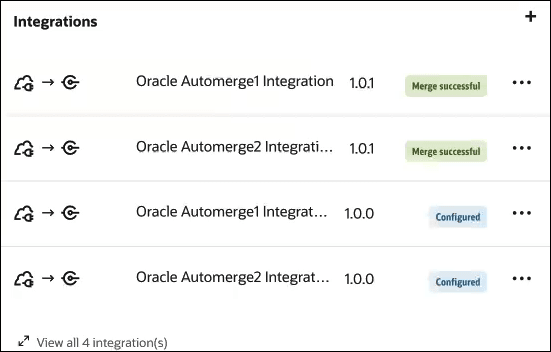

  8. Note that the latest installed versions (1.0.1) are successfully merged above the initial integration versions (1.0.0).
    The Integrations section shows the integrations, calendar icons, versions, the current state (Configured) and Actions menus.
  9. Click the latest integrations (1.0.1) to see that your customizations have been merged.

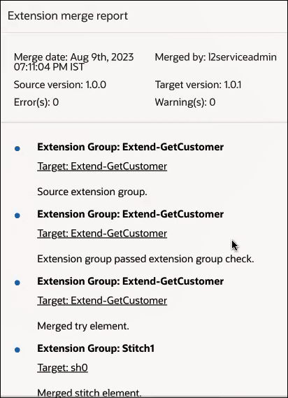

  10. Click Merge report Merge report icon to view a report about the merge.
    The merge report shows the merge date, source version, any errors, the merge user, the target version, and any warnings. The activity stream for the merge is shown below.

If you do not select the Merge latest extensions check box described in Step 5, your customizations are not applied. However, you still have the opportunity to manually merge your extensions.
  1. Select the version to install, but do not click Merge latest extensions.
    The Install accelerator panel shows the accelerator versions available for installation. The v1.0.1 version is selected. In the Merge options section, the Merge latest extensions check box is not selected.

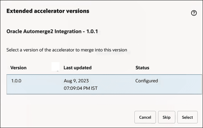

  3. In the Integrations section, click the newly installed version. Note that the status label is listed as Configured, and not Merge Successful for the two newly-installed integrations.
    The Integrations section shows two version 1.0.1 integrations and two version 1.0.0 integrations.
    The Extended accelerator versions dialog prompts you to select to merge your extensions.
    The Extended accelerator versions panel is shown. You are prompted to select a version of the accelerator to merge into this version. At the bottom are Cancel, Skip, and Select buttons.
  4. Click Select to merge your extensions. You can also click Skip if you do not want to merge your extensions.
