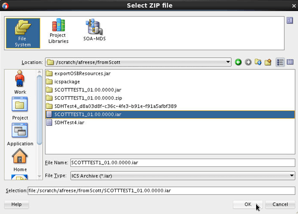

  6. Click the Browse Zip Source icon to the right of the Zip Source field.
    The Select ZIP File dialog is displayed.
  7. If using Oracle JDeveloper 12.2.1.x, perform the following steps:
    1. From the File Type menu, select ICS Archive (*.iar).
    2. Browse for and select the Oracle Integration IAR archive file that you previously exported.
  8. If using Oracle JDeveloper 12.1.3, perform the following steps:
    1. Ensure that you first rename the .iar file extension to .zip.
    2. Browse for and select the ZIP file to import.
  9. Click OK, then click Next on the wizard page.

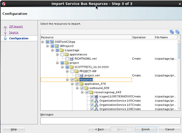

    The contents of the JAR file are displayed and can be selected for import.
  10. Select the resources folder in which to import the archive file. Note that the entire Resource tree is selected by default, including everything above the hierarchy node that you want to select. Ensure that you deselect the parts above the relevant hierarchy node, then click Finish.
    The resources are imported into the Oracle Service Bus project. You can now open the map file for editing with the XSLT Map Editor in Oracle JDeveloper.
