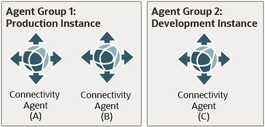

For example, one service instance could have two agent groups, one with two associated agents, and one with one associated agent.

Number of Connectivity Agents in an Agent Group
You can associate one or two connectivity agents with each agent group. The number of connectivity agents to associate with an agent group depends upon your requirements for throughput and resiliency.
| Setup | Why choose this configuration? |
Two agents in an agent group (recommended)
If you opt for this configuration, you must also choose whether both agents are active at one time. See Number of Active Connectivity Agents. |
One agent in an agent group (not recommended for production environments)
This configuration introduces risk. A single connectivity agent creates a single point of failure. However, under the following circumstances, you might decide that this risk is acceptable:
For instance, you might opt for a single connectivity agent for a development environment while installing multiple connectivity agents in a production environment. |
You can also mix and match. For instance, associate two connectivity agents with one agent group, and associate a different connectivity agent with a different agent group.

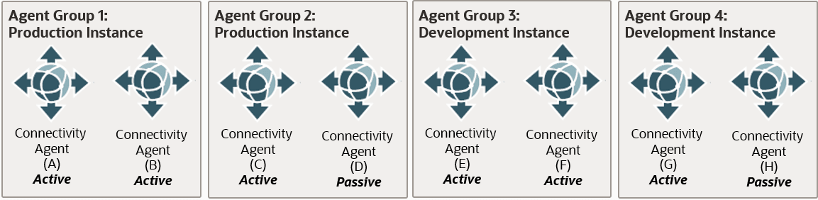

When you create an agent group that holds two connectivity agents, you must specify whether one or both of its connectivity agents are active at a time using the Use only one agent at a time setting.
| Setting | Description | Performance impact |
Use only one agent at a time is not enabled |
Both agents remain active at all times, sharing incoming requests and polling responsibilities.
This setup can result in improved performance when compared to agent groups in which Use only one agent at a time is enabled. |
Use only one agent at a time is enabled |
The first connectivity agent that you install or start is identified as the active agent. This agent handles all incoming requests and polling responsibilities. For example, a File Adapter polls for files in a specific directory. The second agent that you install or start is identified as the passive agent. This agent doesn't handle any incoming requests or polling responsibilities. Instead, it runs in standby mode, ready to take over if the primary agent fails. If the active agent fails, the passive agent becomes active and handles all incoming requests and polling responsibilities. This agent remains active even after the initially active agent recovers from failure. The recovered agent is now passive and remains in standby mode.
This setup can result in lower performance when compared to agent groups in which Use only one agent at a time is not enabled. |
Again, you can create multiple agent groups with different active settings to meet your requirements.
