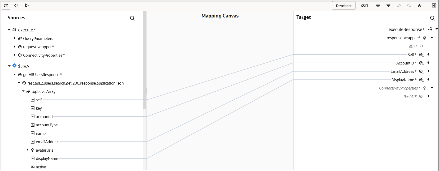

By default, user-friendly names are displayed in the source and target
mapper trees when you open the mapper. Name display is controlled by the
Developer button at the top of the mapper.
- Click Developer to switch to technical
names.
An outline appears around the button, and technical names for the source and target elements are displayed.
- Click Developer to switch back to user-friendly names.

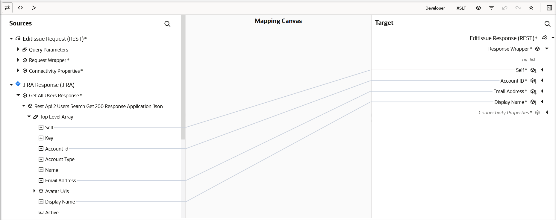

Adapter Names
In user-friendly mode, adapter names are displayed along with the
adapter's associated icon and the type of payload (request/response). For this
example, the source REST Adapter and Jira Adapter and the target REST Adapter are
displayed.
names. The adapter names are removed.
