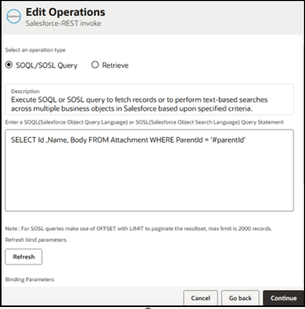

  4. On the Action page, select Query Information.
  5. Select SOQL/SOSL Query as the operation type.
  6. Enter a valid SOQL query for binary large objects to retrieve the Id, Name, and Body using ParentId, or Name as a query condition/binding parameter.
    The Edit Operations dialog is shown. The SOQL/SOSL Query radio button is selected. Below this is the Description field. Below this is the field that includes the following query: SELECT id ,Name, Body FROM Attachment WHERE Parentid = '#parentid'. Below this is the Refresh button and Cancel, Go back, and Continue buttons.

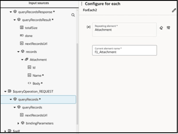

    1. If there are multiple attachments on ParentId, then perform the Download Attachment operation for each attachment.
      1. Drag a for-each action into the integration canvas.
      2. Add the Salesforce REST Adapter.
        The Input sources hierarchy is shown. The queryRecords element is selected. On the right is the Configure for each section. The Repeating element field is shown with a value of Attachment. The Current element name field is shown with a value of f1_Attachment.

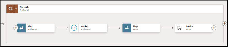

        The for-each action looks as follows:
        The for each action is shown with a map action, invoke connection, map action, and invoke action.

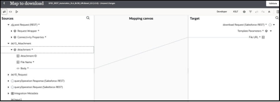

      5. In the mapper, map the source Body element under Attachment response to the target File URL element.
        The Sources, Mapping canvas, and Target sections are shown. The source element Body is mapped to the target element File URL.

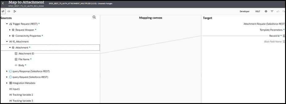

  7. In the mapper, map the source Attachment ID element to the Record Id element.
    The Sources, Mapping canvas, and Target sections are shown. The source element Attachment ID is mapped to the target element Record Id.
