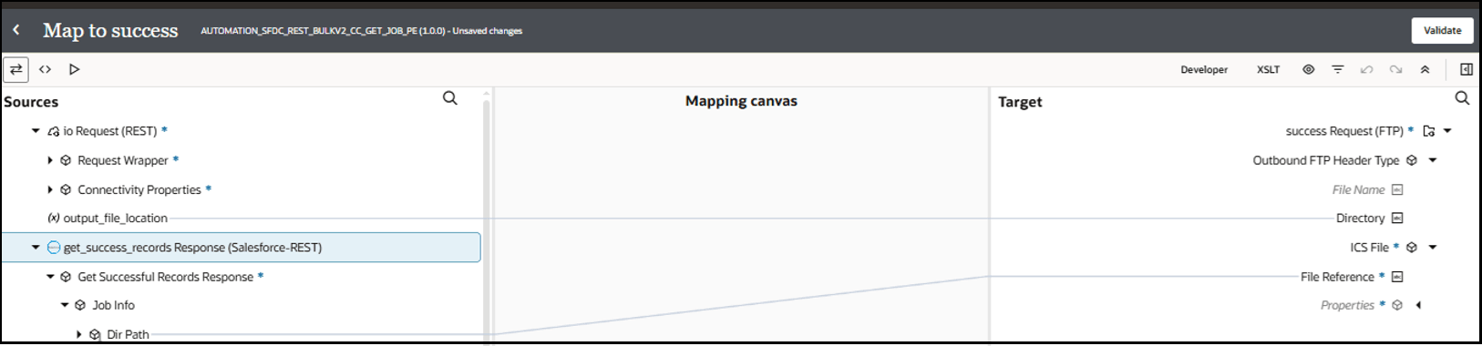

  8. In the mapper for the FTP Adapter invoke connection, map the source Dir Path element to the target File Reference element.
    The Sources, Mapping canvas, and Target sections are shown. The source output_file_location is mapped to the target Directory field. The source Dir Path is mapped to the target File Reference field.
