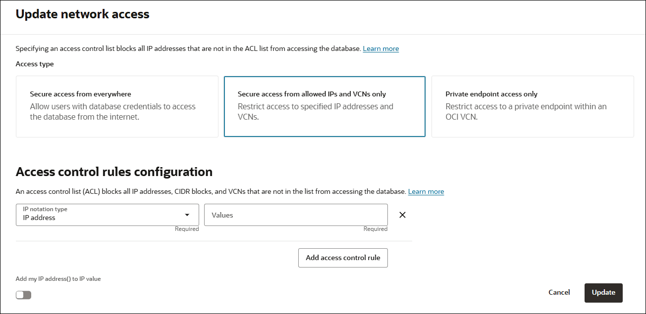

Configure a New Autonomous AI Database for MongoDB
Follow the steps in Provision or Clone an Autonomous AI Database, up to the point where you select your Network Access Type.
Description of adb_network_access_acl_provision.png follows
At this point, to use Oracle AI Database API for MongoDB configure secure access by selecting and configuring one of these network access types:

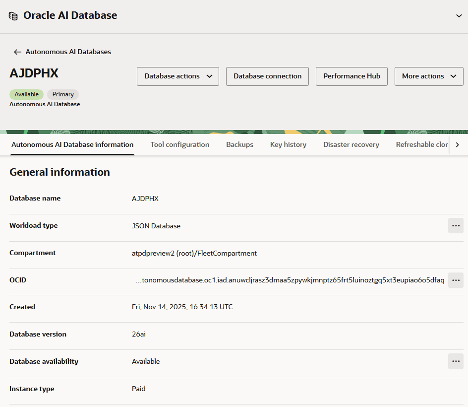

Configure an Existing Autonomous AI Database for MongoDB
Open the Oracle Cloud Infrastructure Console for your Autonomous AI Database instance.
Description of adb_ajd_console_details.png follows

Access Control List (ACL) Setup
See Configure Access Control Lists for an Existing Autonomous AI Database Instance for more information.
To configure your ACL for an IP address, you will need to obtain the public IP address. There are several ways to show your public IP address:
Note: Public IP addresses may change. Any change to your public IP address will require a change in the ACL. If you are unable to access your database, your ACL should be something you check.
ACLs Types and Use Cases
ACL Type Use Case Comment
IP Address Local development laptops sharing the same public IP address Easiest way to get started. Any laptop connected on this LAN will have access to the database with the database credentials.
CIDR Block Local development laptop Using IPv4/32 notation
IP Addresses separated by commas Small number of local development laptops connected on distinct LANs (having distinct public IP addresses) Can be tedious to manage with 10+ laptops.
CIDR Block Local development laptops connected on the same subnet exposed to Internet (each laptop has its own public IP Address) Rely on CIDR Block notation. See calculator here for more information. Example: 89.84.109.0/24 gives 256 possible IP addresses from 89.84.109.0 to 89.84.109.255
VCN with CIDR Block For testing, production, or CI/CD pipeline hosted on OCI having their own VCN and Compute instances Assign OCI compartment per environment type.
Mixing IP Address and VCN with CIDR Block Local development laptop accessing a test Autonomous AI Database with connections from the testing environment or CI/CD pipeline A common configuration option for on-going development work.

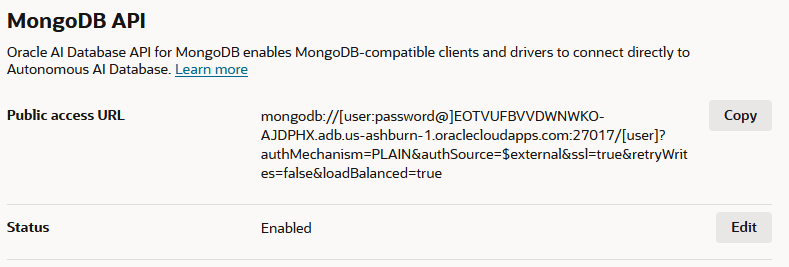

To retrieve the MongoDB API connection string:
  1. On the Autonomous AI Database details page, select the Tool configuration tab.
  2. In the MongoDB API row, under Access URL click Copy.
    Description of adb_tools_mongo_connect_string.png follows

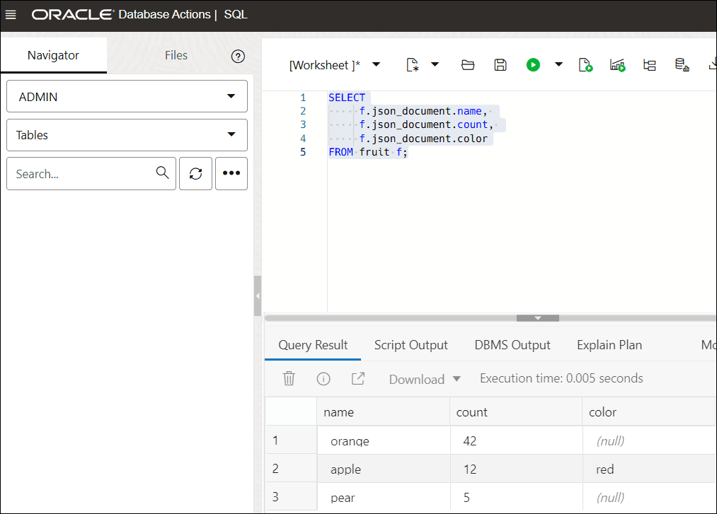

  3. Query the collection using a SQL client such as Database Actions.
    SELECT
        f.json_document.name,
        f.json_document.count,
        f.json_document.color
    FROM fruit f;
    Description of database_actions_sql_for_mongodb_use.png follows
