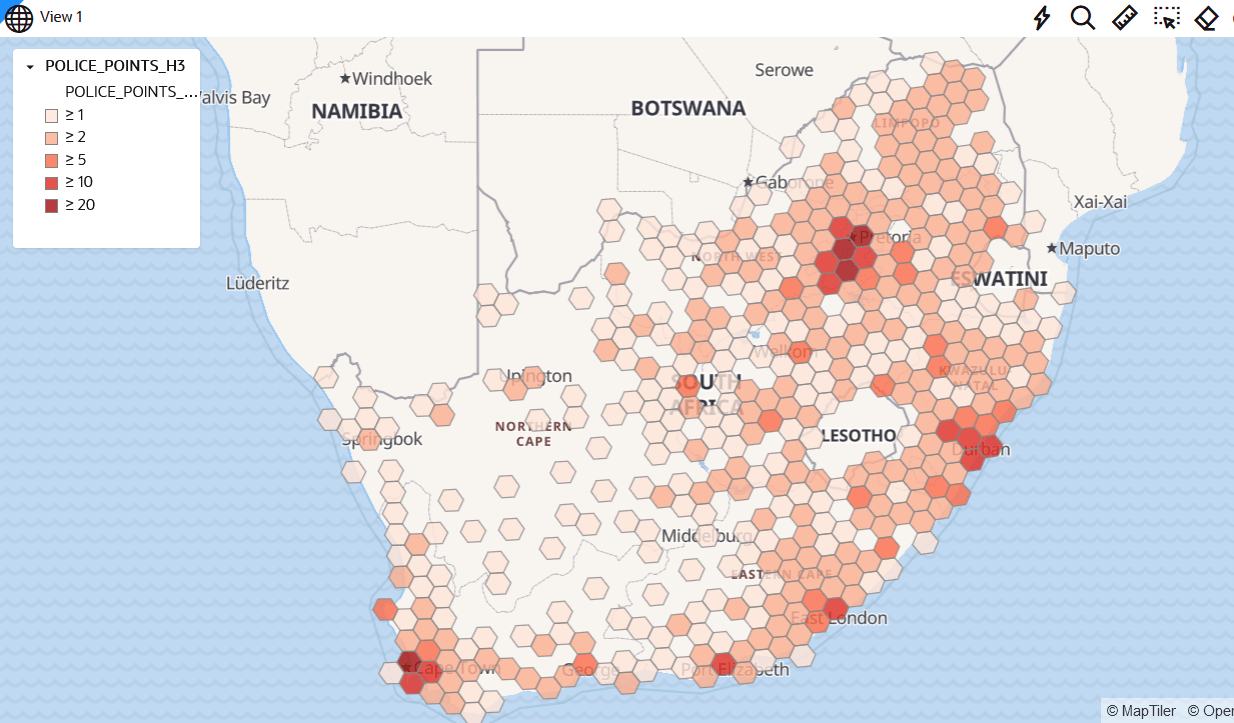

Click and drag the desired H3 Aggregation dataset from the list to the map view on the right.
A layer showing the hexagonal binning of the data points is displayed on the map as shown:
