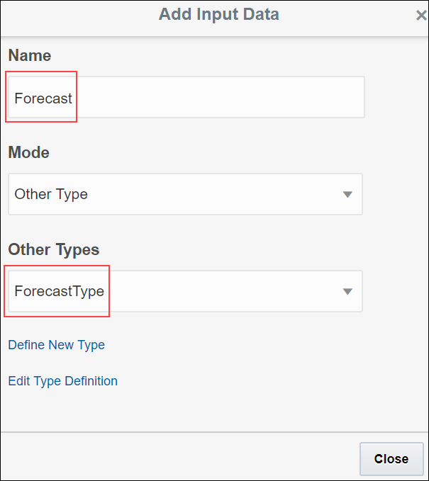

  3. Add an input variable that uses the Forecast type definition you just created.
    1. In the Input Data section, click Add new input data Add new input data icon.
    2. In the Name field, enter Forecast.
    3. In the Mode field, select Other Type.
    4. In the Other Types field, select ForecastType and click Close.
