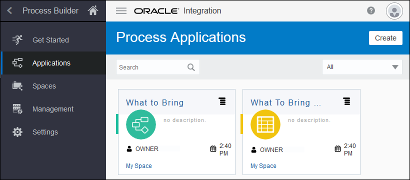

  1. Return to the Process Applications page by clicking Back Back icon in the navigation pane.
    Notice that the page displays both the application and the decision model you created.
    Description of proc-app-page-dmn.png follows

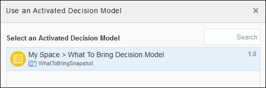

  4. On the Properties pane, click Use Decision Model Use Decision Model icon next to the Decision Model field.
  5. In the Use an Activated Decision Model dialog box, select the snapshot you created and activated (WhatToBringSnapshot), and click Use.
    Description of activate-decision-model.png follows
    Process brings the activated decision model snapshot into the application and performs behind-the-scenes operations such as importing data types and defining the REST connector to the service.

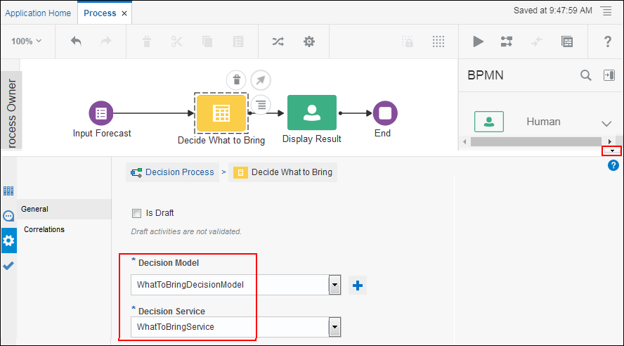

    Notice that the Properties pane now lists the decision model and service you selected to use.
    Description of decision-process-properties.png follows
