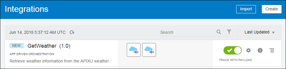

    It might take a few moments before the integration is activated. Click Refresh Refresh icon if the status is in progress. The icon turns green when the integration is active and ready to be invoked.
    Description of integration_activated.png follows
