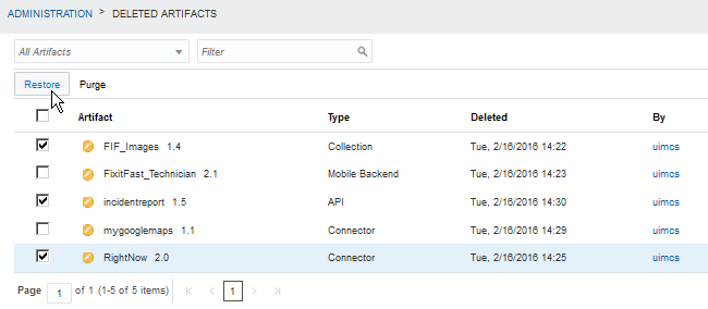

Restoring an Artifact
You might find that you need an artifact that’s been moved to the trash. Restored artifacts retain the same state they had when they were moved to the trash. That is, an artifact in Draft state that was moved to the trash will still be in Draft state when restored.
As with moving an artifact to the trash, restoring an artifact has some considerations:
If the artifact has no naming or version conflict, you can restore it by simply clicking the Trash (
) and selecting Restore from Trash from the Trash drawer (
) and confirming the restoration action.
If duplicate artifacts exist (that is, artifacts with the same name and version) and one of these artifacts is in the trash, you can’t restore the artifact. You must resolve the conflict first in one of the following ways and then restore the artifact:
Move the active artifact to the trash and restore the one already in the trash.
Change the version of the active artifact and then restore the one in the trash.
The following table lists the types of artifacts that can be restored and which dependencies are restored from the trash with each type of artifact. The last column lists the possible upstream and downstream dependencies of the artifact that are not in the trash and that could be affected by the restoration. These items are displayed in the Restore dialog as information only.

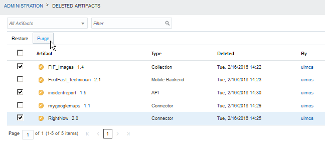

Purging an Artifact
So how do you permanently delete an artifact? You must be a mobile cloud administrator and you purge it via the Deleted Artifacts tab from the Administration view. When an artifact is purged, it no longer appears in the list of trashed items and can’t be restored.
Just as dependencies can affect restoring an artifact, they affect purging an artifact from the trash. If the artifact you want to purge has downstream dependencies, those dependencies are deleted along with the artifact. For example, when you purge an API in the trash, its implementation is deleted as well.
If the artifact is a downstream dependency of another artifact, you need to resolve the dependency with the other artifact before you can purge it.
The following table shows you which dependencies will be purged with a each type of artifact.
| Artifact Type | Dependencies Purged with the Artifact | Dependencies Not Purged with the Artifact |
