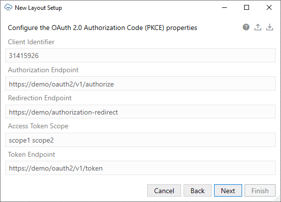

To import a configuration file during new layout creation:
Launch the New Layout Setup wizard as described in either Create a Table Layout in an Excel Workbook or Create a Form-over-Table Layout in an Excel Workbook.
From the first screen of the wizard, select OAuth 2.0 Authorization Code (PKCE) from the Authentication list, then click Next.
The wizard displays a screen for entering OAuth 2.0 properties. This image shows the screen with sample values in the screen’s fields.
Note: You can also access this screen for an existing catalog from the Advanced page of the Business Object Catalog Editor. To open this screen, select OAuth 2.0 Authorization Code (PKCE) from the Authentication list, then click Edit Authentication Flow Properties. See Set an Authentication Method for a REST Service.
