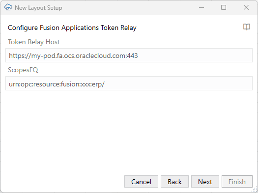

When you configure token relay authentication, you’re prompted to provide values for two optional configuration properties: Token Relay Host and ScopesFQ. If your REST service doesn’t require values for these settings, you can leave them blank.
Provide a Token Relay Host value if the Fusion Applications token relay service is located on a different host than your REST service. If these services are both hosted on the same pod, you can leave this field blank and Oracle Visual Builder Add-in for Excel will use the catalog’s host instead.
Provide a ScopesFQ value if you want to append a scopesfq query parameter value when calling the token relay service. If you leave this field blank, the add-in does not include the scopesfq query parameter.
Consult with your REST service owner or refer to the documentation for your target REST service to determine the appropriate values for these properties.
These optional authentication properties can be configured when you create a catalog during layout creation. They can also be configured for an existing catalog from the Business Object Catalog Editor.

Launch the New Layout Setup wizard as described in either Create a Table Layout in an Excel Workbook or Create a Form-over-Table Layout in an Excel Workbook.
From the first screen of the wizard, select Oracle Fusion Applications Token Relay from the Authentication list, then click Next.
The wizard displays a screen for entering token relay properties. This image shows the screen with sample values in the screen’s fields.
Note: You can also access this screen for an existing catalog from the Advanced page of the Business Object Catalog Editor. To open this screen, select Oracle Fusion Applications Token Relay from the Authentication list, then click Edit Authentication Flow Properties. See Set an Authentication Method for a REST Service.
If the Fusion Applications token relay service is located on a different host than the REST service, type the token relay host in the Token Relay Host field.
The host should use this format:
<protocol>://<host>:<port>. For example:https://my-pod.fa.ocs.oraclecloud.com:443Note: Do not include the path to the Fusion Applications token relay service.

The sample values in the image result in this URL (with URL encoding omitted for readability):
https://my-pod.fa.ocs.oraclecloud.com:443/fscmRestApi/tokenrelay?scopesfq=urn:opc:resource:fusion:xxx:erp/

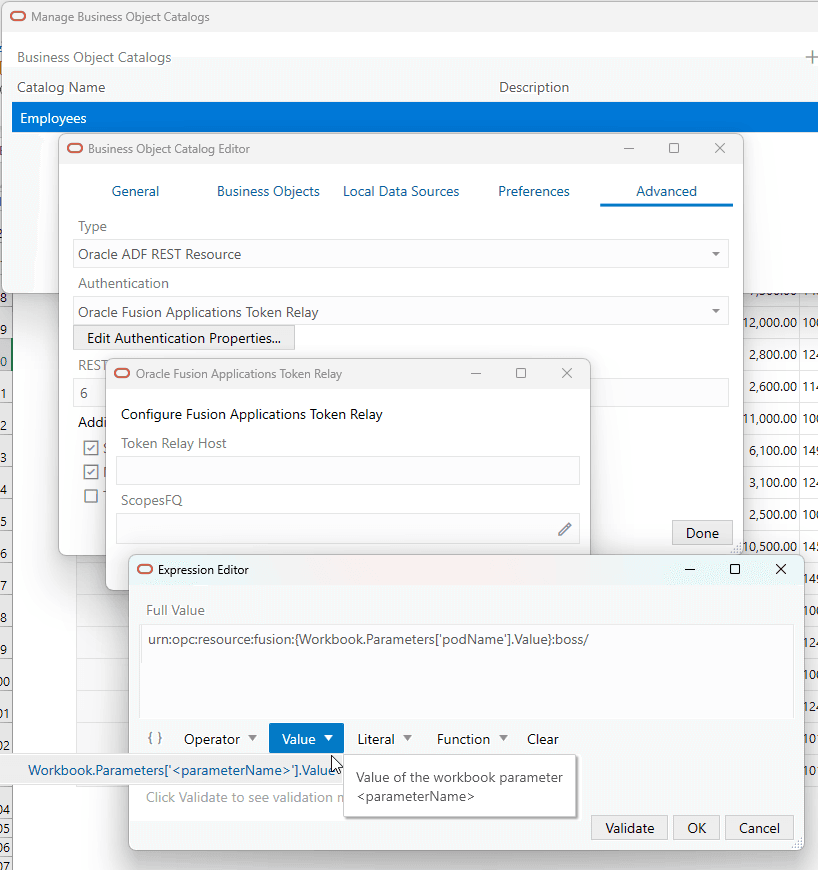

Use Workbook Parameters for ScopesFQ in Fusion Application Token Relay Authentication
You can add expressions that reference workbook parameters in the ScopesFQ property of Oracle Fusion Applications Token Relay Authentication.
For example, you might rely on a workbook parameter in your integrated workbook using the podName value. At runtime, during authentication, this workbook parameter value (podName) is used in place of the expression, yielding the URL for authentication: ....../tokenrelay?scopesfq=urn:opc:resource:fusion:orclpod:boss/
ScopesFQ supports a workbook parameter expression: {Workbook.Parameters['<parameterName>'].Value}. See Workbook Parameters in Expressions and Use Expressions in an Integrated Workbook. For information about embedding workbook parameters in a workbook, see Embedding Workbook Parameters in a Workbook.
To use a workbook parameter for ScopesFQ in the Oracle Fusion Applications Token Relay:
- Click Manage Catalogs.
- In the Manage Business Object Catalogs window, select your catalog and click the Edit Business Object Catalog (
) icon. - From the Business Object Catalog Editor, click Advanced and, in the Advanced tab, select the Edit Authentication Properties.
- In the Oracle Fusion Applications Token Relay window, click the Edit icon (
) in the ScopesFQ field to open the Expression Editor. - In the Expression Editor, from the Value dropdown list choose
"{Workbook.Parameters['<parameterName>'].Value}"to embed a workbook parameter value. -
Replace
<parameterName>with the name of your workbook parameter and click OK.
Note: If the Fusion Applications token relay service is located on the same host as your REST services, then you can leave the Token Relay Host field blank, and the add-in uses the catalog’s host instead.
The add-in handles errors that occur as follows:
If workbook parameters in expressions are not embedded in the workbook, the add-in throws an exception with an error message:
"unable to find workbook parameter with name: <name>" - If expressions in the ScopesFQ property have syntax errors, the add-in throws an exception.
- If workbook parameters in expressions have a value of
nullor white space, the add-in throws an exception indicating the value can’t be null or white space. - When configuring ScopesFQ with a workbook parameter expression, you cannot use the
?.or??operators to handle null since missing parameters result in an exception in this context.
