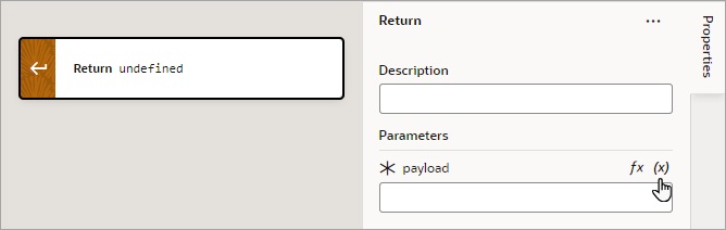

To use a Return action:
  1. Add the action in one of three ways, as explained at the end of Built-In Actions.
  2. For the Payload property, hover over the far-right side of the property and click Select Variable to choose the variable to return.
