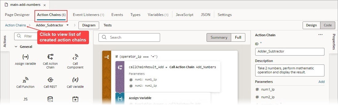

    • Actions Chains Tab:
      If you prefer to go straight to creating an action chain and later assigning it to an event listener, component event, or variable event, go to the relevant Actions Chains tab at the application, flow, or page level. On the Actions Chains tab, click the + Action Chain button. If an action chain is displayed on the tab instead, click the Action Chains link in the Action Chain editor to get to the list of created action chains and the button for creating a new action chain:

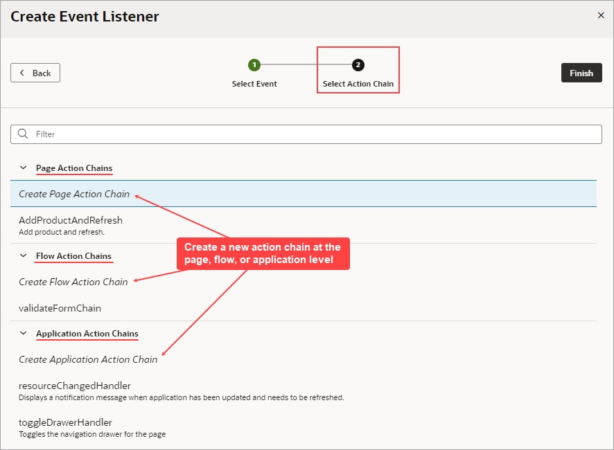

    • Event Listeners Tab:
      To have your new action chain started by a lifecycle, application, flow, or page event (vbBeforeEnter, vbEnter, vbAfterNavigate...), select the Event Listeners tab and click + Event Listener. In the Create Event Listener wizard, select the event and click Next. On the wizard’s Select Action Chain step, select the create action chain option at the appropriate level (page, flow, or application) and click Finish. For further details, see Start an Action Chain From a Lifecycle Event.

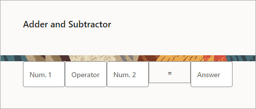

In this example, we implement this Adder and Subtractor interface by creating an action chain that either adds or subtracts two numbers and displays the result:
The interface has:
Each of the four text components is bound to a page variable:
Here, we create the action chain that either adds or subtracts two numbers and displays the result:

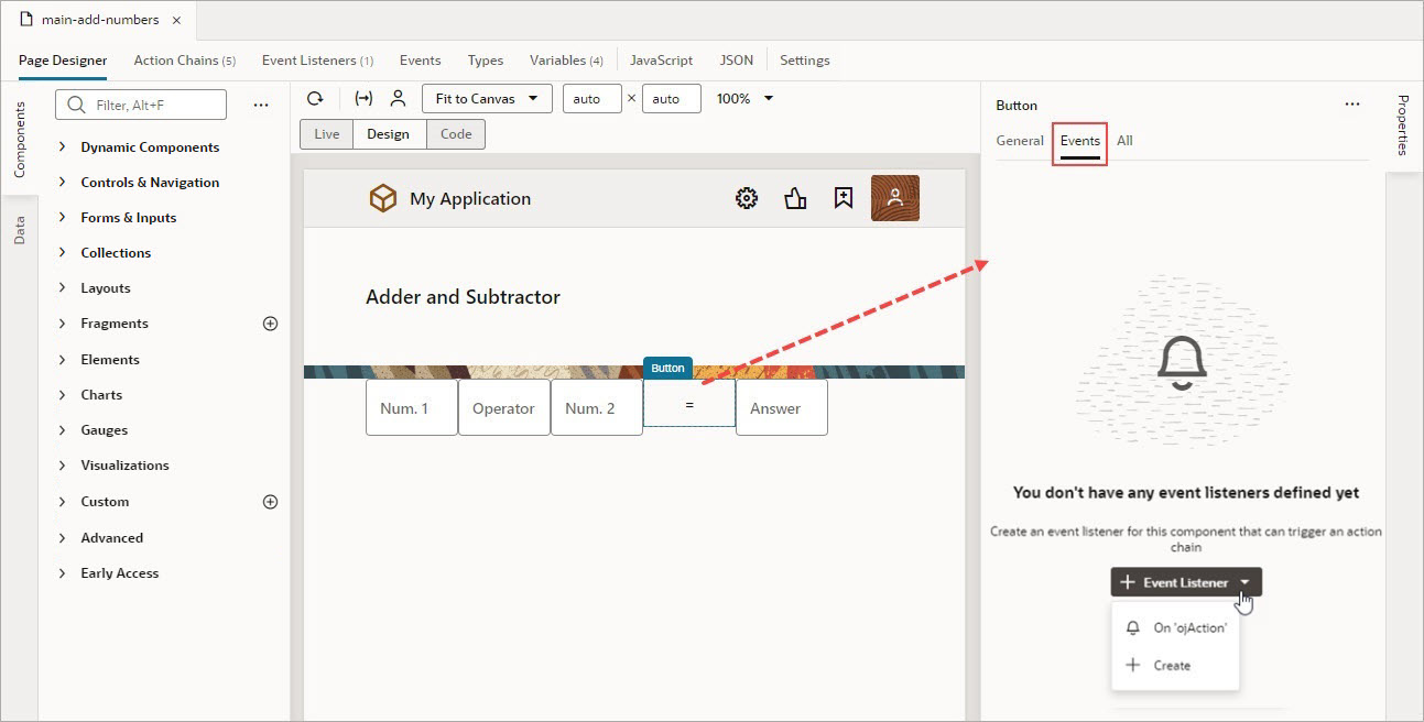

  1. We want the action chain to be triggered by clicking the equals button, so select the equals button on the Page Designer’s canvas, then select the Events tab in the Properties pane:
  2. Click + Event Listener, then On ‘ojAction’ to create an event that’s triggered by clicking the button, as shown above.

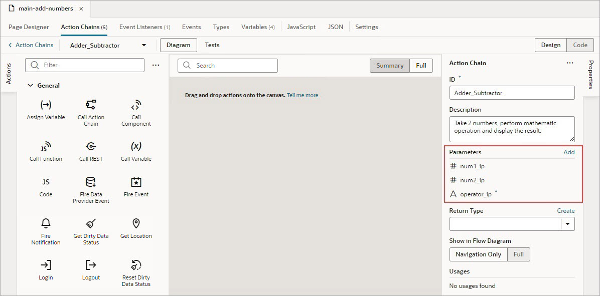

  3. Using the Properties pane, enter Adder_Subtractor for the action chain’s ID field, and optionally a description.
  4. Since three input parameters are needed, two for the numbers and one for the operator, you need to add them using the Add link next to the Parameters property in the Properties pane:

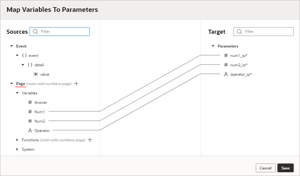

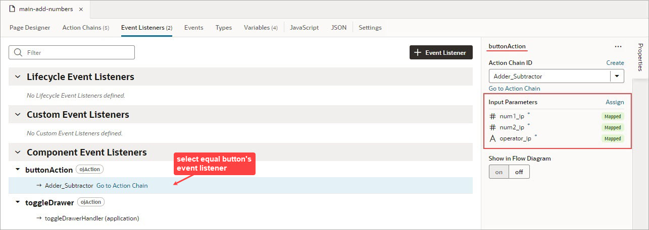

  5. Next, you need to provide the values for your input parameters. Open the Event Listeners tab and select the equal button’s event listener. In the Properties pane, click the Assign link for the Input Parameters property:
  6. In the mapper, map the page variables that were bound to the text components for the numbers and the operator to the action chain’s input parameters:

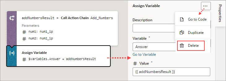

    You now need to assign the result from the Add_Numbers action chain to the page variable that’s bound to the text component that displays the answer.

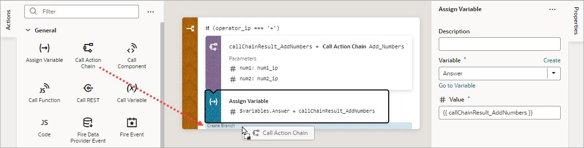

  15. Drag and drop the Assign Variables action to the bottom edge of the Call Action Chain action on the canvas. For the Variable property, in the Properties pane, select the page variable that’s bound to the text component displaying the answer, and for the Value property, select the result from the Add_Numbers action chain:

  16. Drag and drop the Call Action Chain action onto the Create branch area at the bottom of the If condition:
    Description of the illustration jsac-add-second-call-action-chain-action1.jpg
