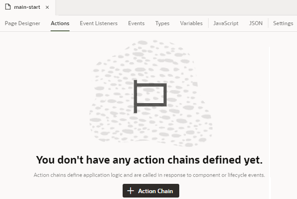

  1. Open the Actions tab, for example, at the page level.
    The Actions tab displays a list of the page’s action chains, or a message if no action chains are defined.
    Description of action-chain-editor-nochains.png follows
  2. Click + Action Chain.

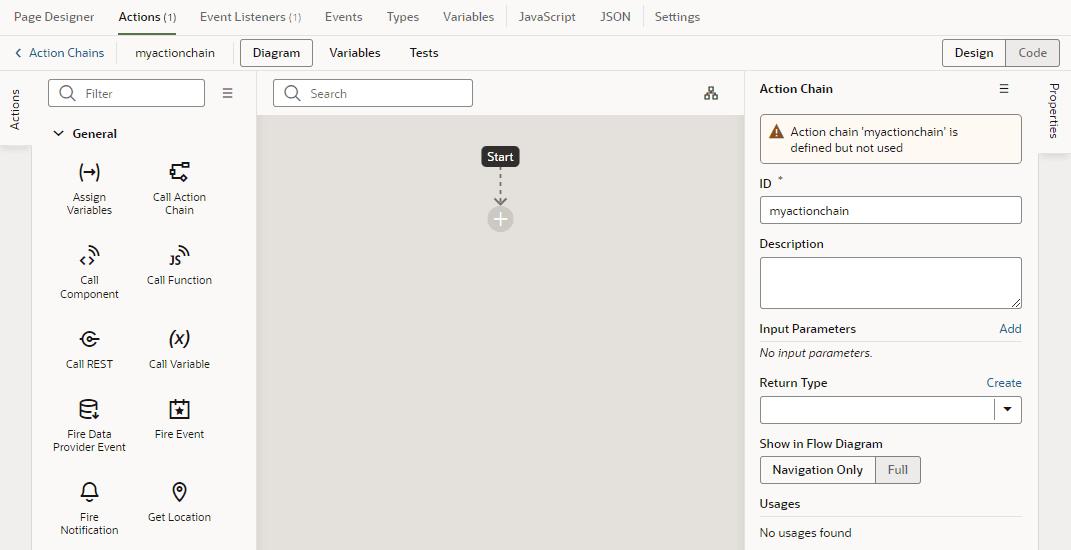

    The new action chain opens in the editor:
    Description of action-chain-editor-canvas-blank.png follows
    The editor contains the palette of built-in actions (grouped by type), a canvas, and a Properties pane. The Start icon in the canvas area indicates the starting point for your action chain; the Add icon ( Add icon ) is a placeholder where you add an action to the chain. The Properties pane shows the properties of what’s selected on the canvas.

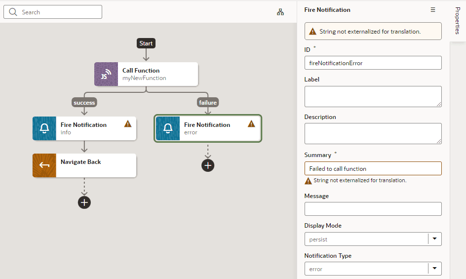

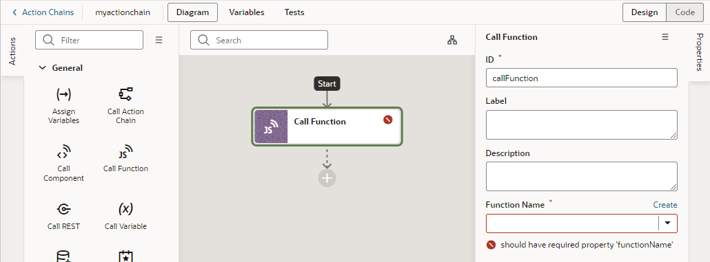

    The new action is added to the chain and is selected by default. The Properties pane displays the properties that you can specify for the action. For example, here’s what the editor looks like when you add the Call Function action in the Design view:
    Description of action-chain-editor-canvas.png follows
    The action is usually flagged with a warning icon when a required field isn’t set (in this case, because a JavaScript function hasn’t been selected yet). Specify the action’s properties as required in the Properties pane. For details specific to an action, see Built-in Actions.
  5. To create a fork in your action chain, drag the action from the palette and drop it on the Add icon next to the action where you want the chain to fork. The Add icon appears next to each action in the chain when you drag an action from the palette.
    Description of action-chain-editor-forkchain.png follows

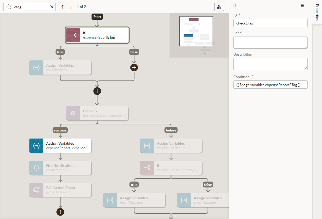

    Tip: When your action chain includes a large number of actions, you can use search to quickly find what you’re looking for. In the Search text box, enter any text—variable name, endpoint ID, or even an action ID from the console log. All actions that match the text you enter will be highlighted, along with navigation arrows that you can use to jump from one highlighted action to the next.
    Here’s an example of using “etag” to find the expenseReportEtag variable:
    Description of action-chain-editor-canvas-search.png follows
    You can also click the Show Overview icon ( Show Overview icon ) to view a visual representation of the action chain’s flow. In combination with search, the overview diagram can help you know where the highlighted action is within the overall flow. Toggle the Show/Hide Overview icon icon to show or hide the diagram as required.

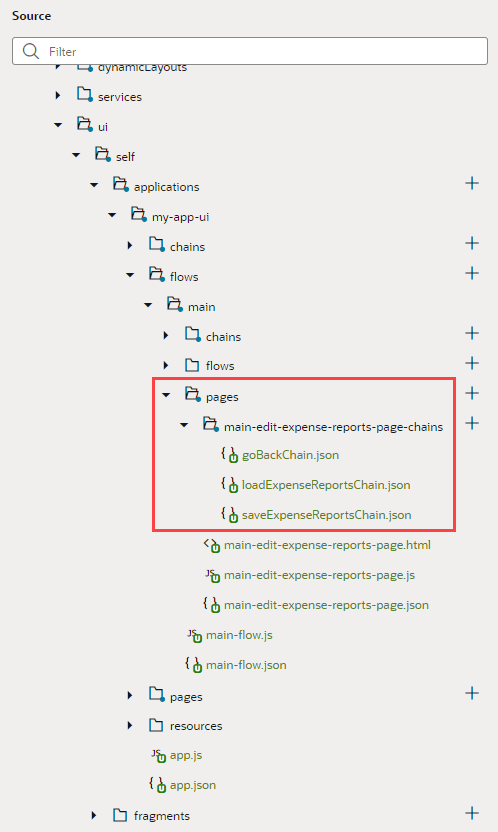

An action chain’s source code is stored in its own JSON file. This helps to optimize performance by reducing the size of the artifact JSON and to reduce the potential for merge conflicts when multiple action chains are edited. To view and edit an action chain’s JSON file, it’s simplest to use the Code editor in the Diagram view, though you can always view files using the Navigator’s Source view. For action chains in App UIs, flows, and layouts, look in the artifact’s chains folder. For action chains in pages, look in the pagename-page-chains folder under pages that’s at the same level as the page JSON file:
Description of action-chains-json-source-view-appui.png follows
