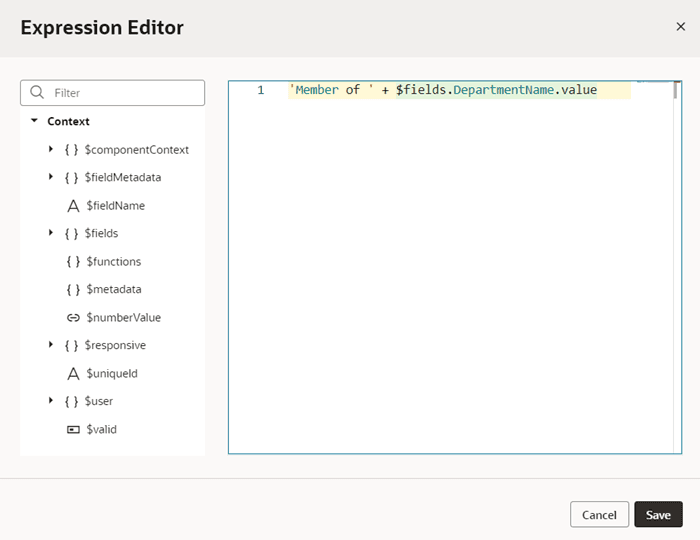

    If you want to use an expression, you can click fx to open the Expression Editor. In the Expression Editor, variables are grouped by context in the Context pane. For example, fields available in the Layout are listed under $fields, and user metadata is listed under $users. You can select a variable in the Context pane to add it to your expression, or start typing in the editor to use the editor’s code completion. You can also add text strings to your expression by typing in the editor. Click Save.
    Description of dynamicui-custom-field-editor.png follows

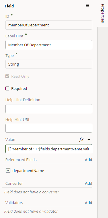

    The expression you create in the editor is added to the Value field, for example, [[ 'Member of ' + $fields.departmentName.value() + $fields.JobName.value() ]].

  7. Optionally, you can click Add to add converters and validators to the field.
    You can add suitable built-in convertors or validators, or create a custom one. If you’re using a referenced field, you might want to add converters or validators to make sure, for example, a string in a field is not too long, or so that dates are formatted the way you want, as shown in Add Converters and Validators to Fields.
Your custom fields (and any fields that you have modified, for example, in the Properties pane) are indicated by a blue dot to the right of the field name. In this screenshot, you can see the blue dot next to MemberOfDepartment.

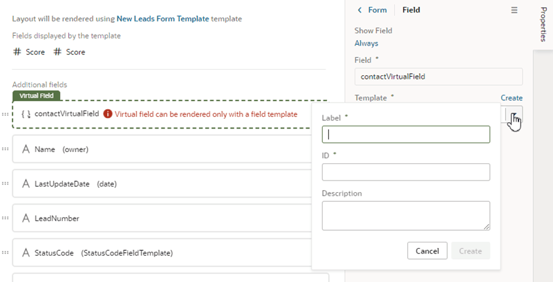

  8. While your virtual field is selected, click Create in the Properties pane and type a name for the template in the Label field. Click Create to open the new template in the editor.
    Description of dynamicui-custom-virtual-template.png follows
    You need to define a field template for the virtual field when you add it to a layout. If a suitable field template for the virtual field already exists, you can select it in the dropdown list. You’ll need to create one if no template exists.
