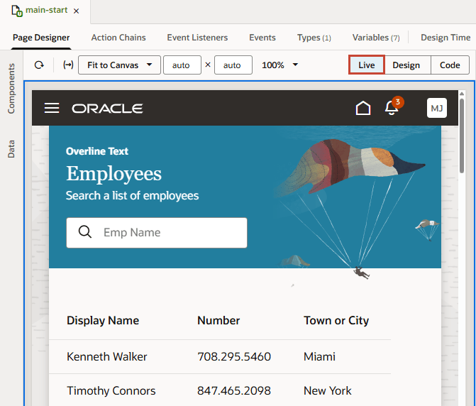

Use Live view to quickly check how a page behaves. Live view is an in-tool preview that you can use to view and debug the page you’re currently viewing in the Page Designer. To view a page in Live view, open it in the Page Designer and select Live in the toolbar:
Clicking Live switches the page to an interactive mode in the canvas area, where you can click components and see changes instantly as you edit. For example, after creating a business rule, switch to Live view and enter values to confirm that the rule is triggered. In this way, Live view enables fast, iterative design because you can immediately check the impact of changes without waiting for a separate preview.
