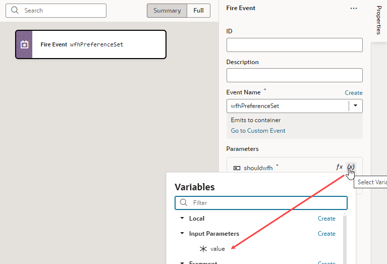

- Create an action chain with the Fire Event action that will be triggered when the event occurs:
- Switch to the layout or fragment’s Action Chains tab, click + Action Chain, enter a ID, and click Create to create a new action chain. You can also select an existing action chain.
- In your action chain, drag and drop a Fire Event action.
- In the Fire Event’s Properties pane, select the event to be fired (for example,
wfhPreferenceSet). -
To pass in the payload parameter’s value, click
next to shouldwfhunder Parameters and selectvalueunder Input Parameters in the Variables picker.
