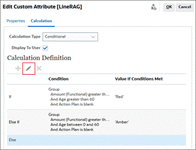

Creating a calculated attribute
In Account Reconciliation, you can create a calculated attribute by completing the following steps:
  1. From the Attributes tab, click Add (New) to create a new attribute.
  2. Click New
  3. In the Properties tab, enter an attribute name, select Text as Type, and select the Calculation checkbox.
  4. Select Calculation
  5. In the Calculation tab, select Conditional as the Calculation Type.
  6. Select Conditional
  7. In Calculation Definition, select the If line, and then click Edit Condition (Edit Condition) to edit it.
  8. Edit Condition
    You can now create an IF_THEN_ELSE statement by creating your own conditions from system and custom attributes.
  9. To group the conditions together, click Create Condition Group.
  10. Click Create Condition Group
  11. To create conditions for this group, click Create Condition. You can create as many conditions as you want.
  12. Click Create Condition
  13. Create three conditions that must be met in order for the attribute to be given a Red value:
  14. a. The transactions amount must be greater than 100,000
    b. The age must be greater than 60
    c. The action plan must be blank
    Each time you create a condition, click Create Condition to add a new condition to your group.
    The value type is constant and set the value as Red. Click OK when finished.
    Click OK
  15. Click Add (Add) to add a new If statement.
  16. Click Add
  17. Create an Amber criteria by following the steps 5 through 7.
  18. Create Amber criteria
  19. After creating the Red and Amber criteria, create the Green criteria by using the Else statement. Select Else and then click Edit Condition (Edit Condition) to edit it.
  20. Click Edit Condition
  21. Type Green as the value for your condition. This marks all transactions that don't fit the Red or Amber criteria as Green. Click OK.
  22. Type Green
