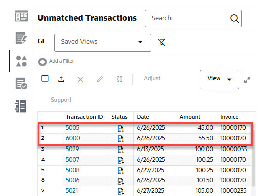

    The new split transaction (Transaction ID, 6000) displays along with the original transaction (Transaction ID, 5505). The split transaction copies all details from the original transaction except the balancing amount and the transaction ID.

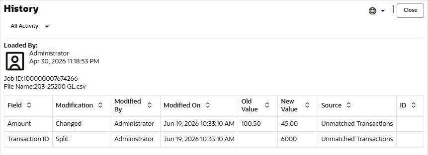

Here is an audit trail example of a transaction (Transaction ID, 5005) with a balancing attribute amount $100.50 split in to amounts $45.00 and $55.50. The Modification displays Split and the New Value displays the new Transaction ID, 6000.

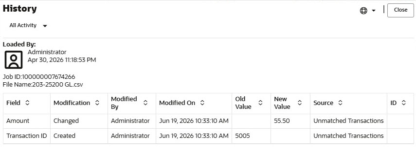

Here is the audit trail example of the newly created split transaction (Transaction ID, 6000). The Modification displays Created and the Old Value displays the parent ID, 5005.
