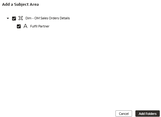

  5. In Add a Subject Area, select Dim – OM Sales Orders Details dimension and Fulfil Partner attribute to extend these to the transaction details and click Add Folders.
    The Add a Subject Area dialog displaying the Dim – OM Sales Orders Details dimension and Fulfil Partner attribute

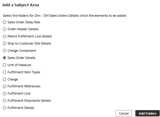

  6. In Add a Subject Area, select Sales Orders Details folder and click Add Folders.
    The Add a Subject Area dialog displaying the selected Sales Orders Details folder

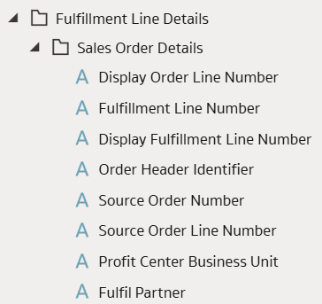

  3. Expand the Fulfillment Line Details folder, then expand the Sales Order Details folder, and verify that the new field Fulfil Partner is available to use and data remains accurate.
    The expanded Fulfillment Line Details folder displaying the newly added Fulfil Partner field
