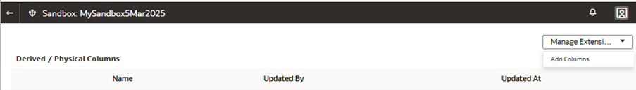

  2. On the Sandbox: MySandbox5Mar25 page, click Manage Extension and then click Add Columns.
    The Sandbox: MySandbox5Mar25 page displaying the option under Manage Extension

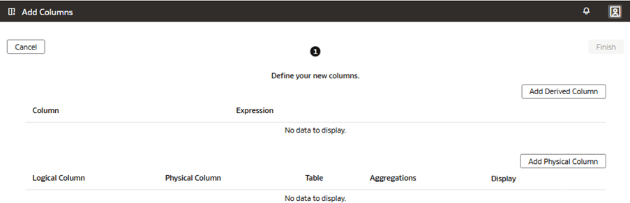

  3. On the Add Columns page, click Add Physical Column.
    The Add Columns page

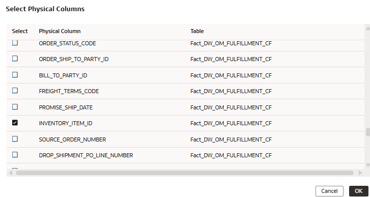

  4. In Select Physical Columns, select the check box for ORGANIZATION_ID and INVENTORY_ITEM_ID, and then click OK.
    The Select Physical Columns page
    These columns come from the Fact_DW_OM_FULFILLMENT_CF table.

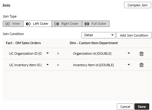

  2. In the Join dialog, set Join Type as Left Outer, set Content level to Detail, set Join Condition as follows and then click Done:
    • For Fact – OM Sales Orders, select UC Organization ID (DOUBLE) and for Dim – Custom Item Department, select Organization Id (DOUBLE).
    • For Fact – OM Sales Orders, select UC Inventory Item ID (DOUBLE) and for Dim – Custom Item Department, select Inventory Item Id (DOUBLE).
    The Join dialog

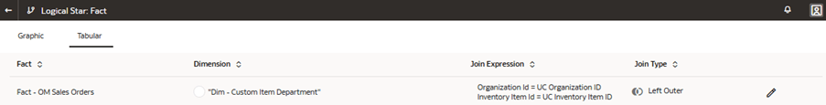

  3. Review the custom joins in the tabular format.
    Custom joins in the tabular format

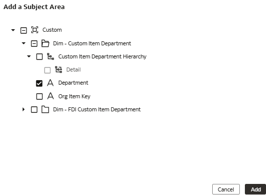

  4. In Add Subject Area, under Custom, select the Department attribute column, and then click Add.
    This adds the Dim - Custom Item Department folder to the semantic model and places the Department column within the folder.

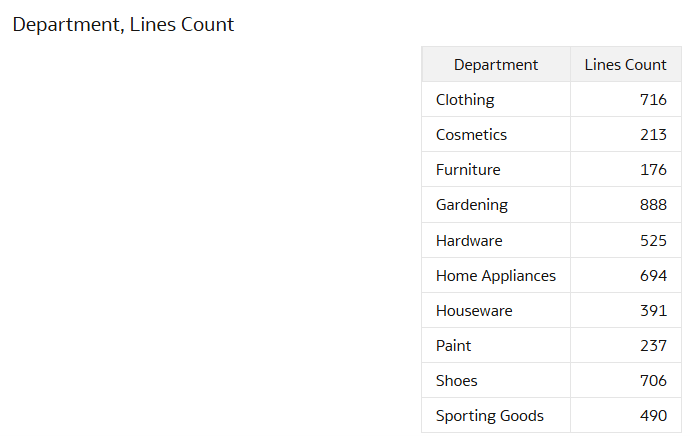

  4. Drag a measure such as Lines Count from the Facts - Sales Orders folder to confirm that the fact can join to the custom dimension.
    A measure from the Facts - Sales Orders folder
  5. Verify the results.
    The result displaying that the prebuilt fact can join to the custom dimension
