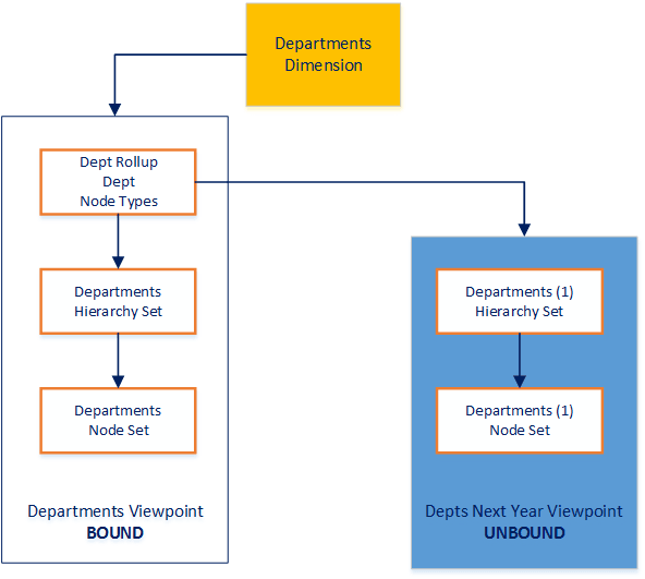

  • Our company will be adding operations in Germany next year. We need to start planning for that change.
  • We have an existing Departments viewpoint. This viewpoint is bound to the Departments dimension.
  • We’ll create a copy of the Departments viewpoint to use as a starting point for our Depts Next Year viewpoint.
  • We’ll make changes to the Depts Next Year viewpoint – adding the new Germany parent and its children.
  • When we’re ready to include the Depts Next Year viewpoint in our application, we’ll change the viewpoint that’s bound to the Departments dimension and export the dimension.
This diagram shows the data objects for the bound viewpoint and the new objects that will be created from copying the existing viewpoint and copying relationships only. We’ll reuse the same node types that are used in the copied viewpoint.
diagram showing bound and unbound data objects
