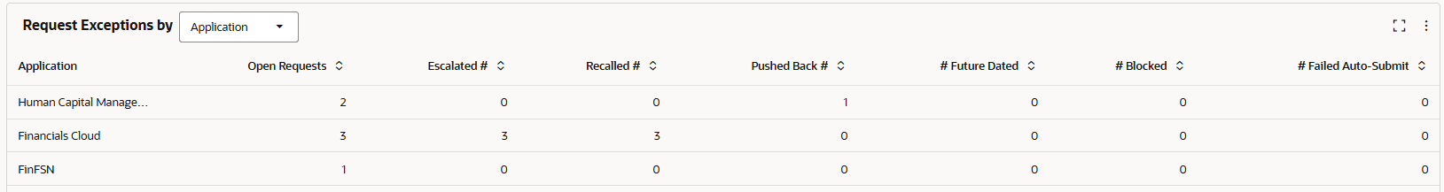

Request Exceptions by (Application or View)
The Request Exceptions by (Application or View) dashboard shows the open requests that have had exceptions, grouped by application, dimension (if one application is selected in your filter), view, or viewpoint (if one view is selected in your filter).
The request exceptions that are displayed include the number of requests that were escalated, recalled, pushed back, future dated, or blocked at least once in their workflow. The Failed Auto-Submit column displays the number of requests that had subscriptions that were configured to be submitted automatically but that were prevented from doing so by validation issues.
The exception numbers in the chart do not indicate the number of requests that are currently blocked, or pushed back, etc. They just indicate that at some point during the request workflow, an exception was encountered.Also, a single request could have encountered more than one exception type during its workflow. For example, a request might have been escalated and then recalled. So the number of exceptions listed in the chart may not always add up to the total number of open requests in the first column.
For each element in the chart, you can drill down to view the request activity, drill
across to view the requests in another visualization, or apply the specifics of that
element to the page filter. You can also use the Actions menu
to view and download the request activity in the visualization. See Working with Dashboard Panels.
