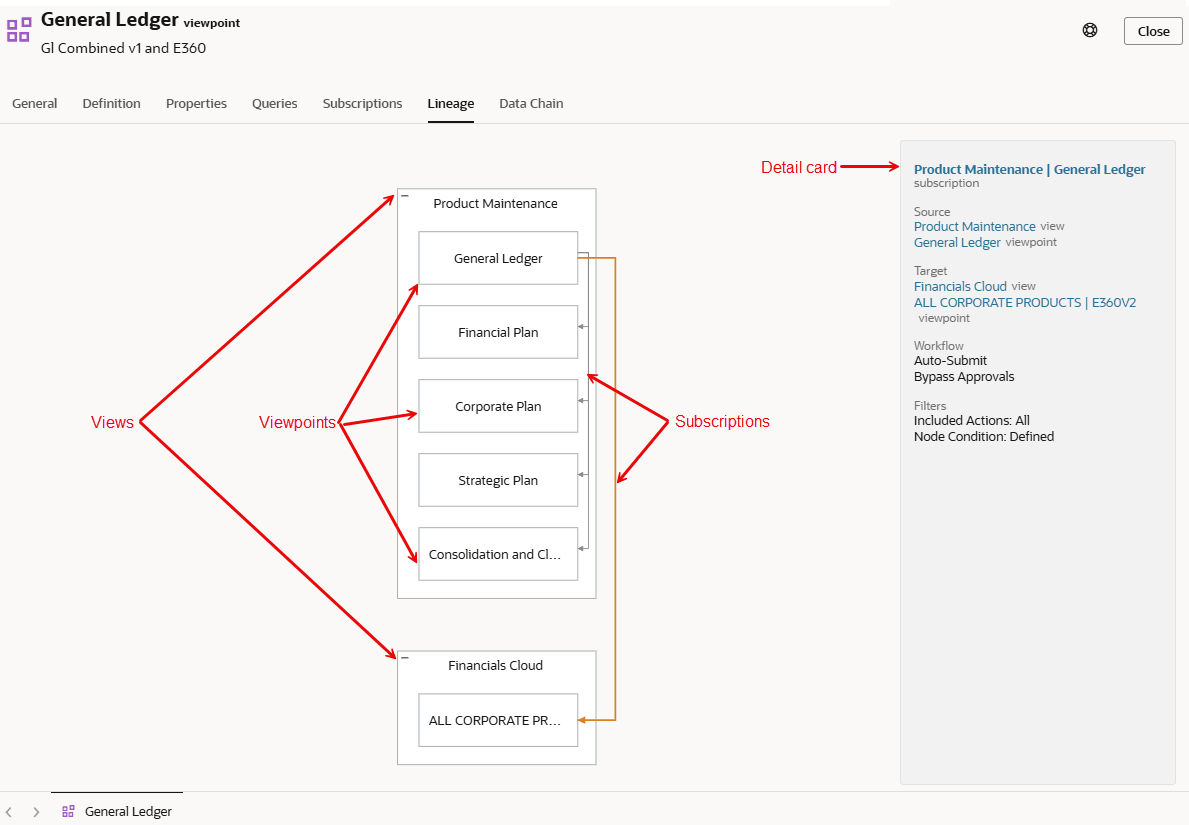

The Lineage tab of the viewpoint inspector displays a diagram for the viewpoint that shows the subscriptions in which the viewpoint is either a source or a target.
This enables you to see how viewpoints across different applications are connected by subscriptions and how changes are synchronized from one viewpoint to other viewpoints.
viewpoint lineage diagram. Details described below
Each view in the diagram is represented by a box, and the viewpoints in the view are displayed within that box. Only viewpoints with a subscription to or from the current viewpoint are displayed. Subscriptions are represented by arrows between viewpoints. Only subscriptions that are enabled are displayed.
Click a view, viewpoint, or subscription to view details about that item in the detail card. From the detail card, click the name of a view, viewpoint, or subscription to inspect that item. If you select a viewpoint, you can click any of the following to inspect that item:
