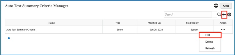

  1. In the Grid Designer select Actions, and then select Auto Text Summary Criteria Manager.
  2. In the Auto Text Summary Criteria Manager, you can create a new Criteria Definition or edit an existing Criteria Definition.
    Creating a new Criteria Definition

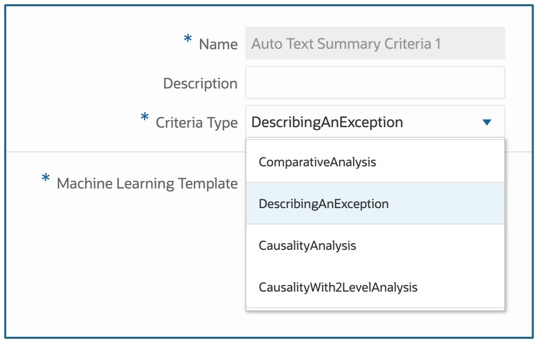

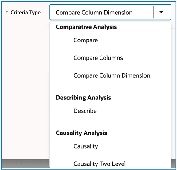

  3. In the Criteria Definition Editor, specify a name for the definition and select one of the following Criteria Type:
    • Compare
    • Compare Columns
    • Compare Column Dimension
    • Describe
    • Causality
    • Causality Two Level
    Criteria Type: Compare Column Dimension
