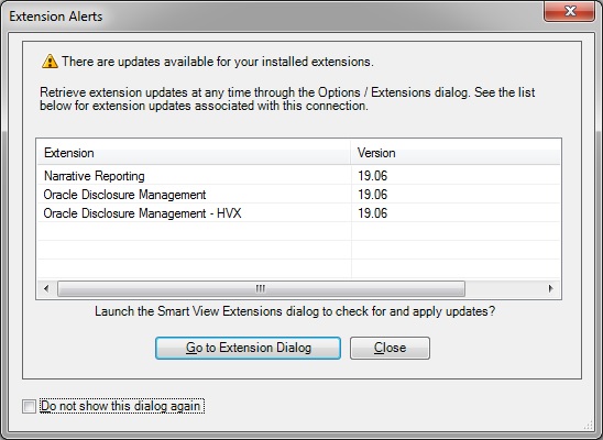

      Upon connection, Oracle Smart View for Office compares the extension versions available on the provider environment with the versions installed on your computer. If there are extensions to install or update, the Extension Alerts dialog is displayed. This dialog informs you of the Narrative Reporting and Disclosure Management extensions available for installation or update.
      Figure 22-3
      Figure 22-3 Extension Alerts Dialog Showing Extensions Available for Installation
      Extension Alerts dialog, showing the extensions available for installation. In this example, all three extensions related to Narrative Reporting are available for installation:
