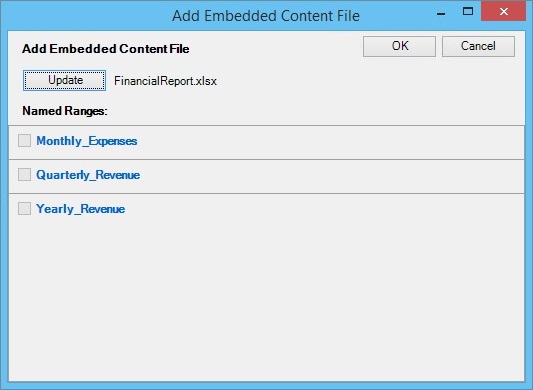

    The Add Embedded Content File dialog box lists the content "registered" with the doclet in order to be made available for embedding. For example, in Figure 18-25, the Excel file that was selected as a reference file contained three named ranges; therefore, these three named ranges can be registered as available content with the doclet.
    Figure 18-25 The Add Embedded Content File Dialog Box Listing Available Content Items
    The Add Embedded Content File dialog box, showing three ranges from the selected reference file can be registered as available content with the doclet.

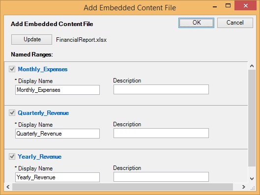

  7. Click the range names that you want to make available for embedding in the doclet.
    The check mark that appears next to the range name shows that the range is now registered with the doclet. For example, in Figure 18-26, we selected all three available ranges to register them with the doclet.
    Figure 18-26 The Add Embedded Content File Dialog Box After Registering Ranges
    The Add Embedded Content File dialog box, showing the three available ranges selected to register them with the doclet

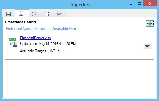

    You are returned to the Embedded Contents tab of the Properties dialog. The reference file is now registered with the doclet, as shown in
    Figure 18-27 Properties Dialog, Embedded Content Tab, Showing Registered Reference File
    The Properties dialog, Embedded Content tab, listing the reference file that just registered with the doclet
