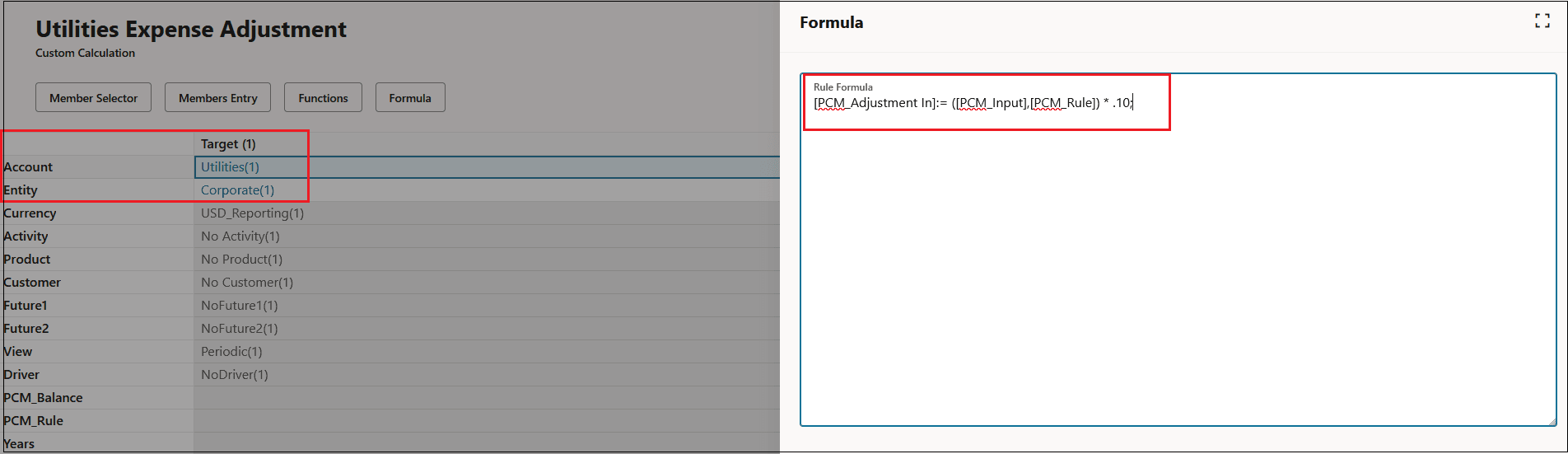

In this example, the Account and Entity dimensions are specified for the target range for the calculation, and the formula will be executed for all cells in that range.
Example of a Calculation Rule
The custom rule in this example is used in the BksML50 sample application provided with Enterprise Profitability and Cost Management. See Creating the Sample Application for information on how to access the sample application.
