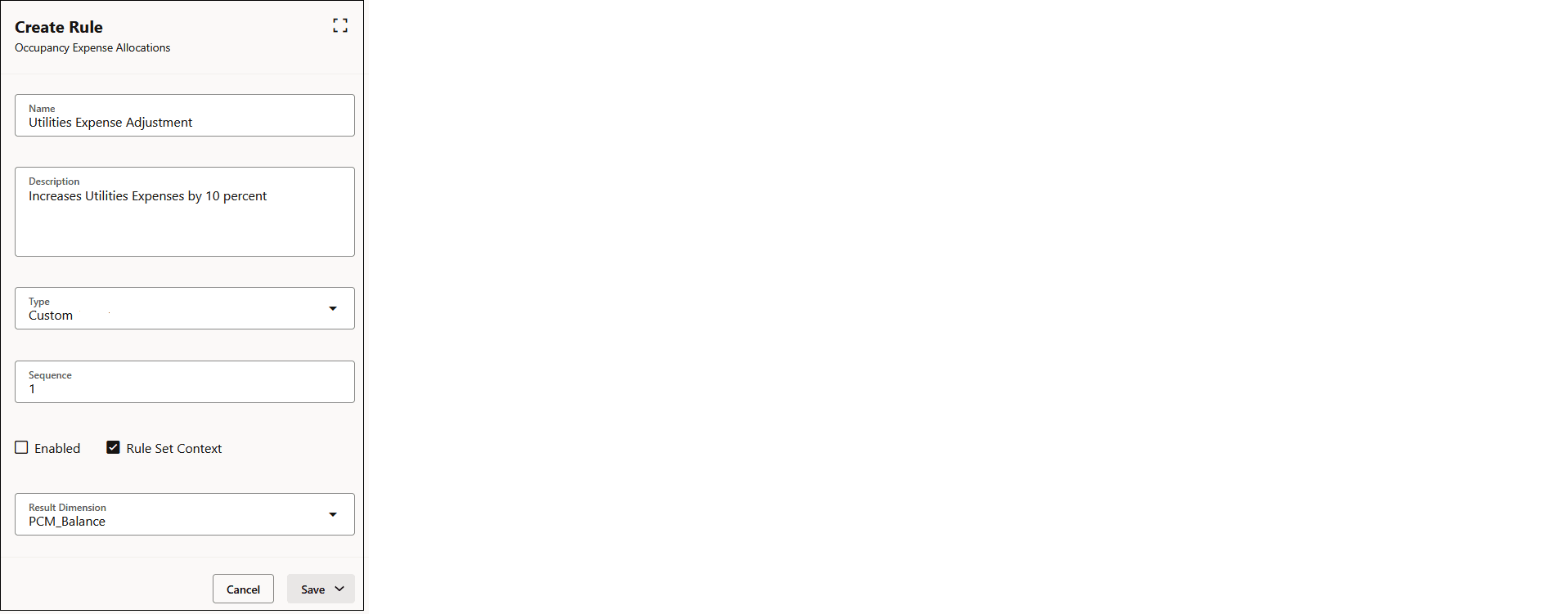

  5. In the Create Rule panel, enter the following information:
    • Name: Enter a name for the rule.
      For example, the "Occupancy Expense Allocations" rule set in the the BksML50 sample application provided with Enterprise Profitability and Cost Management, contains a custom rule called "Utilities Expense Adjustment".
      Rule names have the same restrictions as the member names in Oracle Essbase. See Naming Restrictions for Dimensions, Members, and Aliases.
    • Description: Enter a description for the rule.
      For example, you could say something like; "Increases utilities expenses by 10%"
      The description you enter here will appear in the Model Documentation report. Enter a description that will make the information about the custom rule informative for anyone reviewing the model logic in the future. See Generating a Model Documentation Report.
    • Type: Select Custom.
    • Sequence: Enter a number to determine the order in which the rule will run in the rule set.
      The Sequence can be any whole number from 1 to 9999.
      Rules with the same sequence number will run at the same time if parallel calculation is enabled for the parent rule set, and depending on the number specified for Calculation Threads in the Applications Settings. (See "Step 5: Select a Rule Set Calculation Option" in Creating a Rule Set and "Calculation Threads" in About Managing Application Settings.)
    • Enabled: If selected, the rule will be active when the calculation is performed.
    • Rule Set Context: If selected, the member selections done when the rule set was created will apply to this rule. If a Model Context has been enabled for the rule set, it will also be applied. See Understanding Model and Rule Set Context.
    • Result Dimension: Select a result dimension. The Result Dimension defaults to the PCM_Balance Dimension.
  6. When you are finished entering the information in the Create Rule panel, click Save, and then select either:
    • Save and Close to return to the Waterfall Setup tab, or
    • Save and Next to continue adding rule definitions for additional rules
In the following example, the Utilities Expense Adjustment rule is defined as a Custom rule and will be the first rule run in the Occupancy Expense Allocations rule set. It will not be enabled by default, it will use a previously-defined Rule Set Context, and PCM_Balance is the Result Dimension.

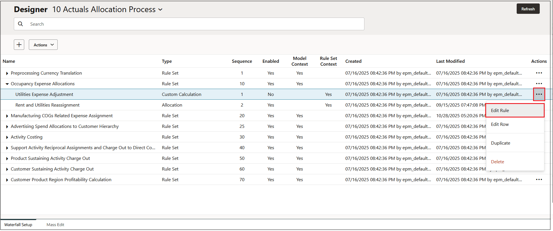

The rules defined in the Create Rule panel are displayed in the Waterfall Setup tab. Select the rule and click Edit to enter additional information about the custom rule.
Utilities Expense Adjustment rule highlighted in the Waterfall Setup tab with the Edit Rule menu option selected
