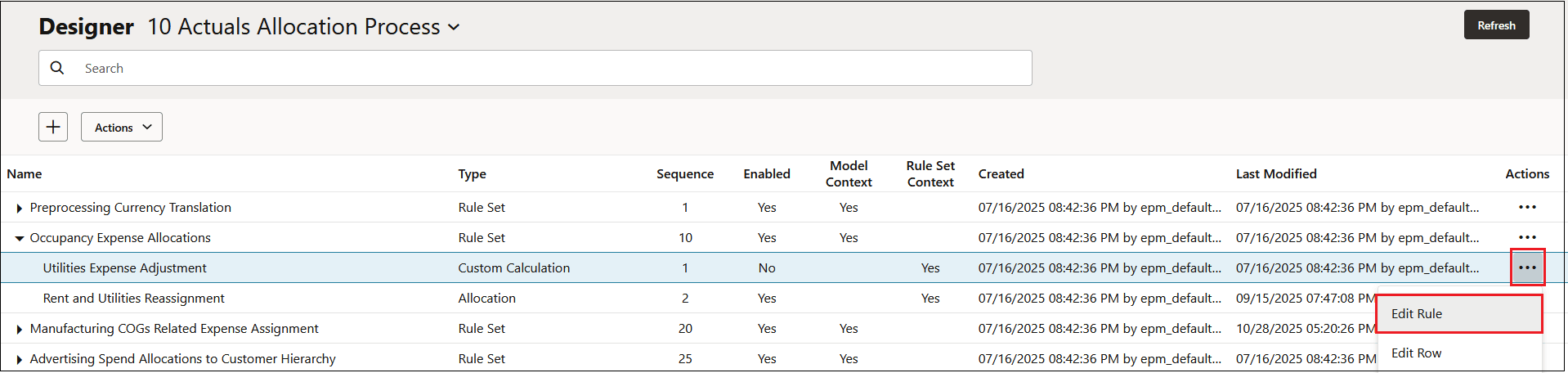

  1. On the Waterfall Setup tab, select a custom rule, and then click Edit.
    Utilities Expense Adjustment custom rule highlighed with Edit selected

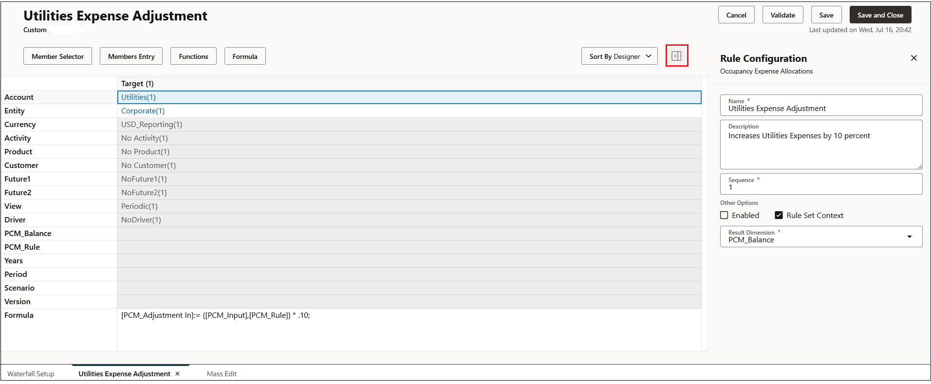

  2. Click Open Configuration icon to open the Rule Configuration panel where you can see the information you defined in the rule definition.
    Utilites Expense Adjustment custom rule with the Rule Configuraiton panel displayed

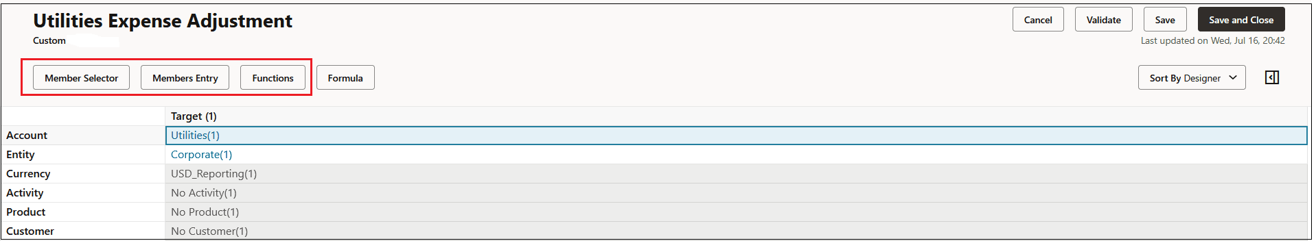

    • Click in the Target column next to a dimension to enable the Edit button, and then click Edit.
      Sample Target information
    • In the Edit Target Component panel, define the target members for the dimension by doing one of the following:

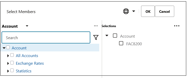

      • Click Member Selector to open the Select Members dialog box, where you can select the members to add to the target dimension. See Using the Member Selector.
        Select Members dialog box FAC8200 selected for the Account Dimension
        Tip:
        Selecting an upper-level member selects all the descendants of that member. For example, if you choose "All Accounts", then your selection is really all the Level 0 descendants of "All Accounts". The rule will execute an allocation for each level-0 member. Selecting an upper-level member eliminates the need to pick each specific member individually.

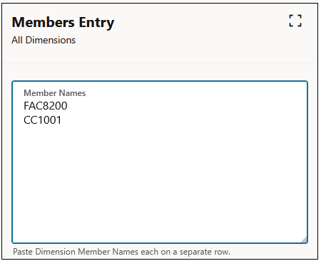

      • Enter member names, one per line, in the Dimension Members area.
        Dimension Members displaying the FAC8200 and CC1001 members
        Tip:
        If you have a list of members in an Excel spreadsheet, you can copy these members from Excel, and then paste them into the Dimension Members area. The members will be added to the dimensions to which they were assigned when the dimensions were created. See Adding Members to a Dimension.
