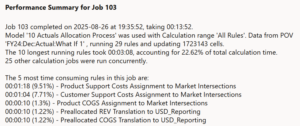

Performance Summary for Job
Summarizes the key performance results of a job to help you identify potential problem areas that may be slowing down calculation performance.
Performance Summary example

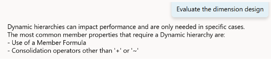

Evaluate the Dimension Design
Provides best practices on how to design the hierarchy type of your dimensions to improve calculation performance.
Evaluate the Dimension Design example

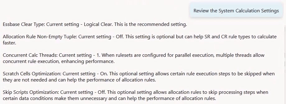

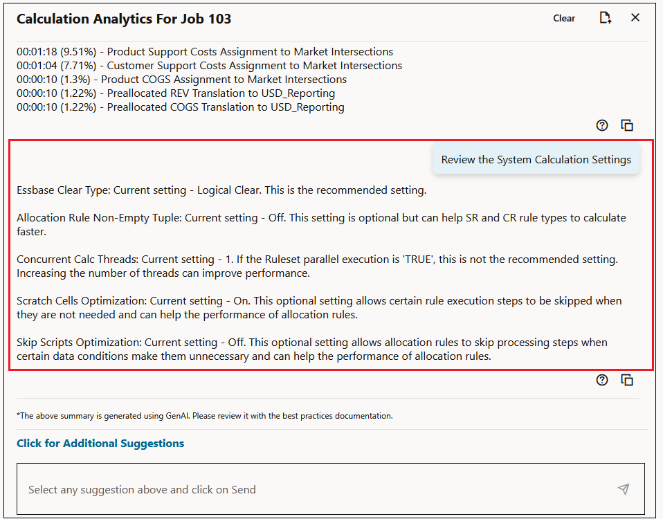

Review the System Calculation Settings
Displays the current settings for "Essbase Clear Type", "Allocation Rule Non-Empty Tuple", "Concurrent Calc Threads", "Scratch Cells Optimization", and "Skips Scripts Optimization" so you can see what may need to be changed to improve calculation performance.
For more information on these settings, see Managing Application Settings.
Review the System Calculation Settings example

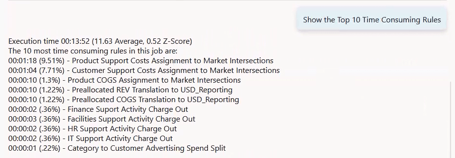

Show the Top 10 Time Consuming Rules
Shows the top 10 time consuming rules for the job. This allows you to focus on and fine-tune individual rules that are slowing down calculation performance.
Top Ten Time Consuming Rules example

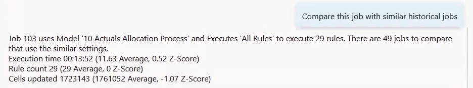

Compare Job with Similar Historical Jobs
Compares the execution performance of a specific job with other recently-run jobs with the same settings in the same model. Information compared includes the average and Z-Score for the execution time, rule count, and cells updated for the specific job with the values for jobs with similar settings. This helps you to see if something has changed to make the job run slower.
Compare this job with similar historical jobs example

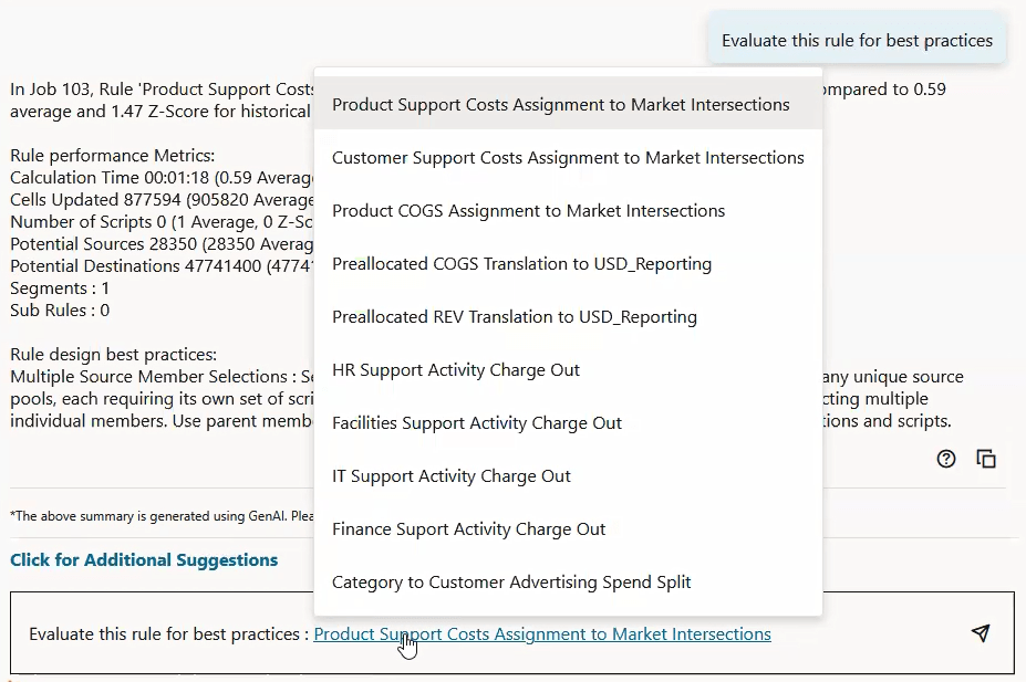

Evaluate Rule for Best Practices
Evaluates the rule to see if it is following best practices. Follow the best practices recommendations to make the rule run faster.
You can review the top 10 most time consuming rules from here. The link for the longest running rule is initially displayed. Click on this rule to display the top 10 time consuming rules. You can select any of these rules to review the details about those rules, and make changes to enable the rule to run faster.
Evaluate rule for best practices example

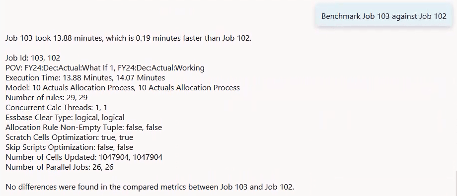

Benchmark Job
Compares two jobs. For example, if you have a job that used to be fast but now it is slow, you can benchmark the fast and slow jobs to see what changed.
When comparing jobs, you must select a job to compare to the benchmark job. By default, all jobs with same processing type and model as the benchmark job are displayed. Select a comparison job by clicking on the hyperlink for the job.
Benchmark job example

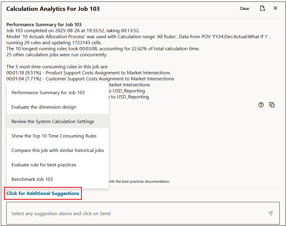

To use the Performance Assistant:
  1. From the Home page, select Modeling, and then Calculation Analysis.
  2. From the Calculation Analysis page, select a calculation record.
  3. Click Analyze Performance.

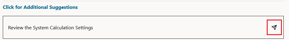

The initial information displayed is a performance summary for the selected job. Select Click for Additional Suggestions to display a drop-down where you can select additional suggestions.
Figure 11-1 Performance Assistant Suggestions
GenAI suggestions displayed in the drop-down for sample Job 103
After you select a suggestion, click Send button (Send) to display the Performance Assistant recommendation.
Review the System Calculation Settings information the with the Send button
Review the system calculation settings recommendation
