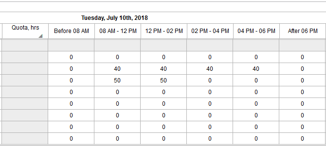

  4. Click > to access the quota editor on the Quota column.
    The editor to manage quota for each booking interval is displayed.
    Quota editor for booking intervals.
  5. Enter the values in absolute time units (minutes/hours/days) as defined on the Business Rules page.
    Note: If the Manage quota on booking intervals level check box is selected, then you must either manage all quota on the booking intervals level. That is, you must enter all the quota values for all the capacity categories and all the booking intervals. Any non-entered entry is considered as zero, that is, booking for such a combination of capacity category and booking interval is prohibited. By default, if no values are entered for quota on booking intervals level, all the values are set to 0, which means that the booking is prohibited for the entire area. Also, you can use the Quota API to enter the quota values. Currently, mass populate or autofill for quota values are not supported on the booking intervals level.
