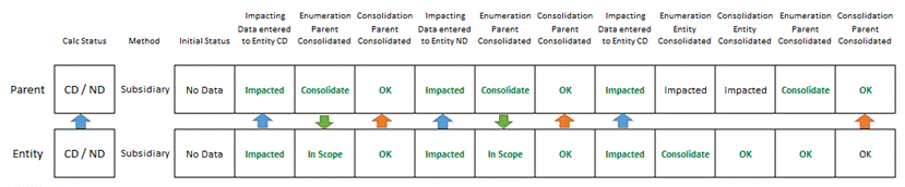

If new data is introduced to Entity Input of an entity, the calculation status of the entity, each instance of the entity, and all of its active ancestors will be changed to the status of Impacted. Impacted data is data that is expected to change after a new consolidation process is carried out. In addition, data points in the following period will also be Impacted, with the expectation that the Opening Balances in that subsequent period will also change when re-consolidated. When a data point in the following period is impacted, that change also impacts the active ancestors of that impacted entity.
If Enhanced Organization by Period is not enabled, all ancestors are considered active, and new data or a change to data in any of the consolidation members will be recorded in the Calc Status system account. All data in the entity will have a common status regardless of the Consolidation dimension member.

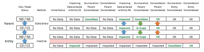

If Enhanced Organization by Period is enabled, then there are two calculation status accounts, Calc Status representing Common Data and Node Status representing Node Data. When new Common Data is introduced and Calc Status is Impacted, Node Status of the same entity is also Impacted because it is expected that Proportionalization and other consolidation rules executed from a changed data set will also change Node Data (Proportion data as a minimum). When Node Status of an entity is Impacted, either by a change in Common Data or by new or changed data in a Node Data Consolidation dimension member, then Calc Status of the parent entity will also be impacted. The impacting flow will be from Calc Status to Node status of the same entity, then to Calc Status of the parent(s), then Node Status of the parent(s), then to Calc Status of the grandparent(s) and so on up the entity hierarchy.
The exception to the upward impacting of dependent calculation status accounts through the ancestors in the entity hierarchy when Enhanced Organization by Period is enabled occurs when an entity has been assigned the Inactive consolidation method. For data impacting, the Inactive method assignment creates a break-point between Common Data and Node data of the entity. In this case, although the Calc Status is impacted, the Node Status is not impacted because Proportionalization and other calculations of Node Data based on Common Data are not executed for an Inactive entity. Node Status of an inactive entity is only impacted by new data or changed data in one of the Node Data Consolidation dimension members, or by impacting of the Node Status for the same point of view in the previous period. All entities assigned consolidation methods (seeded or user-created) other than the seeded Inactive method are considered Active.

If a consolidation is invoked from an entity that has an Impacted calculation status, then only other points of view that are Impacted will be included in the enumeration, including Impacted points of view in prior periods of the current year. If the consolidation is invoked from a point of view that has a System Changed calculation status, then System Changed and Impacted points of view will be included in the enumeration, System Changed points of view in prior periods will not be included in the enumeration.
If Enhanced Organization by Period is not enabled, the system will check for an Impacted or System Changed status starting at the Calc Status of the selected point of view from which the consolidation was invoked. If found, the Calc Status of all children of that point of view will be checked. All Impacted or System Changed points of view will be added to the enumeration. The same logic is then applied to each of the points of view added to the enumeration. This downward enumeration ends when a calculation status of OK is encountered or when the process reaches a level 0 entity.
If Enhanced Organization by Period is enabled, the system will check for an Impacted or System Changed status starting at the Node Status of the selected point of view from which the consolidation was invoked. If found, the Calc Status of the selected Point of View will be checked, followed by the Node Status of all children of that point of view. All Impacted or System Changed points of view will be added to the enumeration. The same logic is then applied to the Node Status and then the Calc Status of each of the children of the points of view added to the enumeration. This downward enumeration ends when a calculation status of OK is encountered, when an Inactive entity is encountered or when the process reaches a level 0 entity. The downward enumeration will end at the Node Status of any Inactive entity
If the consolidation is invoked from an Inactive entity, the enumeration process will begin from the Calc Status instead of the Node Status of that entity. As a result, the Node Data of an Inactive entity can only be consolidated by invoking a consolidation from an ancestor of the Inactive entity.
