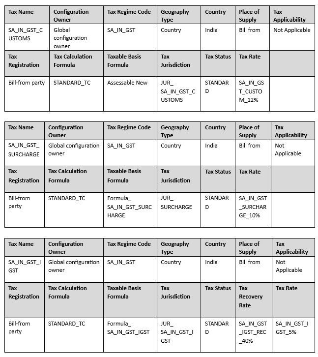

  2. Create taxes:
    1. Sign in as Tax Manager.
    2. Navigate to Setup and Maintenance, Financials, and Transaction Tax.
    3. Search for and select the Manage Taxes task.
    4. Click Add and create taxes.
      The tax reporting code CUSTOMS will be seeded from 19.07. It isn’t available in 19.04. You must assign the code to the respective custom tax defined in the application from 19.07. The application will identify Payables invoices with the taxes assigned to CUSTOMS tax reporting code as BOE invoice, and run the recovery mechanism process and validation for import of goods.
    5. Create three taxes as follows:
      This image shows the taxes to be created and their details:
      This image shows the taxes to be created and their details in tabular format.

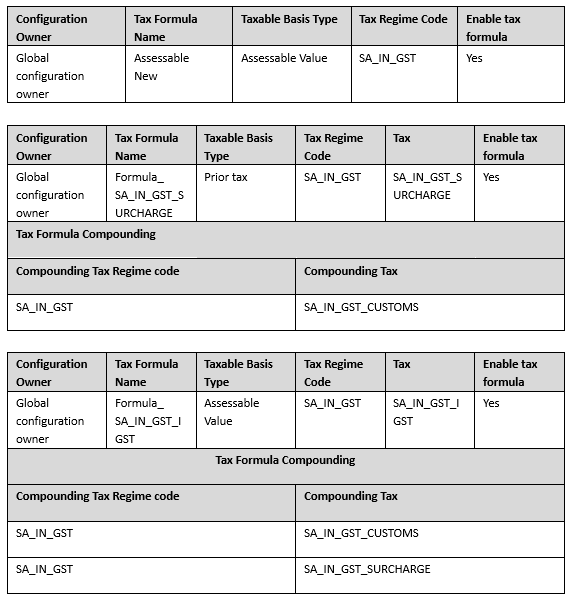

  8. Define the taxable basis formula:
    2. Navigate to Setup and Maintenance, and select Financials and Transaction Tax.
    3. Search for and select the Manage Tax Formulas task.
    4. Click Add and create Taxable Basis Formulas with these attributes. Enter these values to create tax formula:
