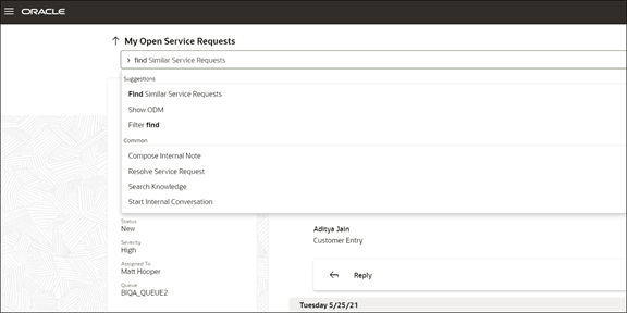

  8. Verify and test the feature in the application:
    1. Navigate to service requests in the application.
    2. Click an existing service request.
    3. Click the Restore Pane arrow.
      If you can view the Similar SRs tab, the feature has been enabled.
    4. Click the Similar SRs tab.
      You can test and start using this feature.
