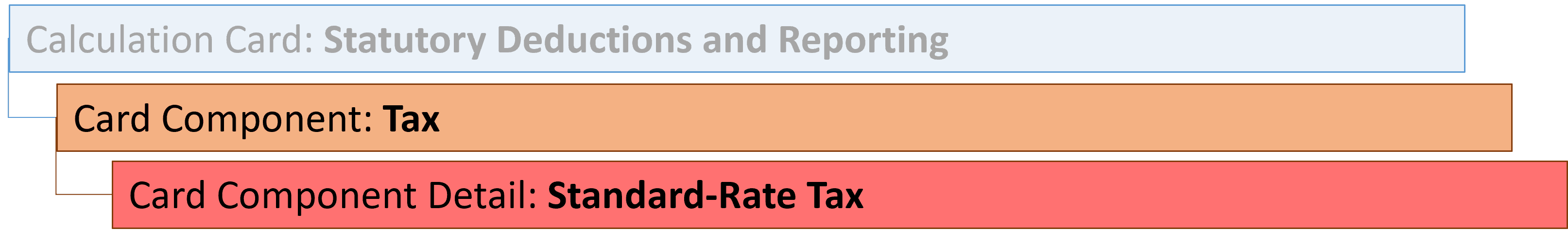

The Tax card component records an employee’s standard-rate and special-rate tax information, this includes their tax code, income code, and previous year’s special-rate income.
The Tax card component uses a single flexfield context which is loaded using the Component Detail record type.
