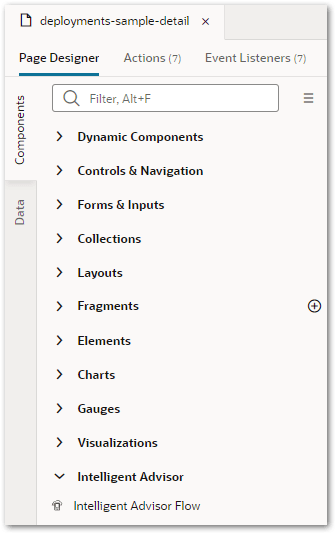

  4. Add the Intelligent Advisor Flow component to the page where you would like to embed the Intelligent Advisor flow. To do this:
    1. Open the Web Applications tab in the Navigator.
    2. Select the page (where you would like to embed the flow) to open it in the Page Designer.
    3. In the Components palette, locate the Intelligent Advisor Flow component.
      The Intelligent Advisor Flow component in the Page Designer palette in Visual Builder
    4. Drag and drop it into position on the canvas or in the Page Structure view.
      For more information, see Add Components to Pages.

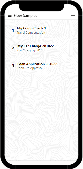

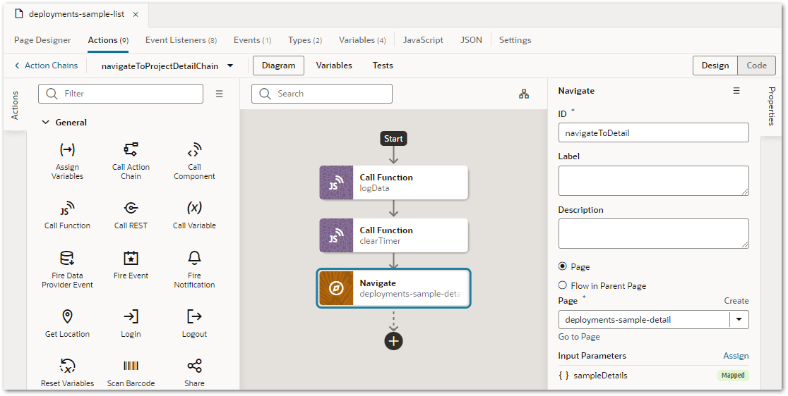

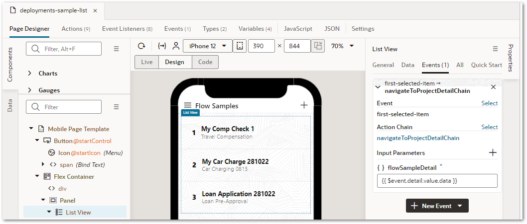

        For example, you could expose a variable (for instance, flowSampleDetail) as a required input parameter of the page containing the flow component. This variable could be set when the user is navigated to that page from another page. For instance, clicking a flow on the start page of the application, could trigger an action chain (navigateToProjectDetailChain) registered on the list of flows.
        Samples start page in a mobile flow in a Visual Builder application

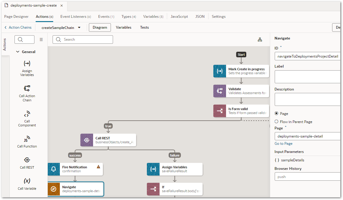

        This action chain would contain an action to navigate to the page containing the flow component.
        An action in a Visual Builder application used to navigate to the page containing the Flow component
        A mapping for this Navigate action is required to map the flowSampleDetail variable in the navigateToProjectDetailChain to the sampleDetails parameter.
        A mapping for a Navigate action in a Visual Builder application using the Intelligent Advisor Flow component
        The flowSampleDetail value is initially from the $event.detail.value.data which is determined by the user clicking one item of the flow list.

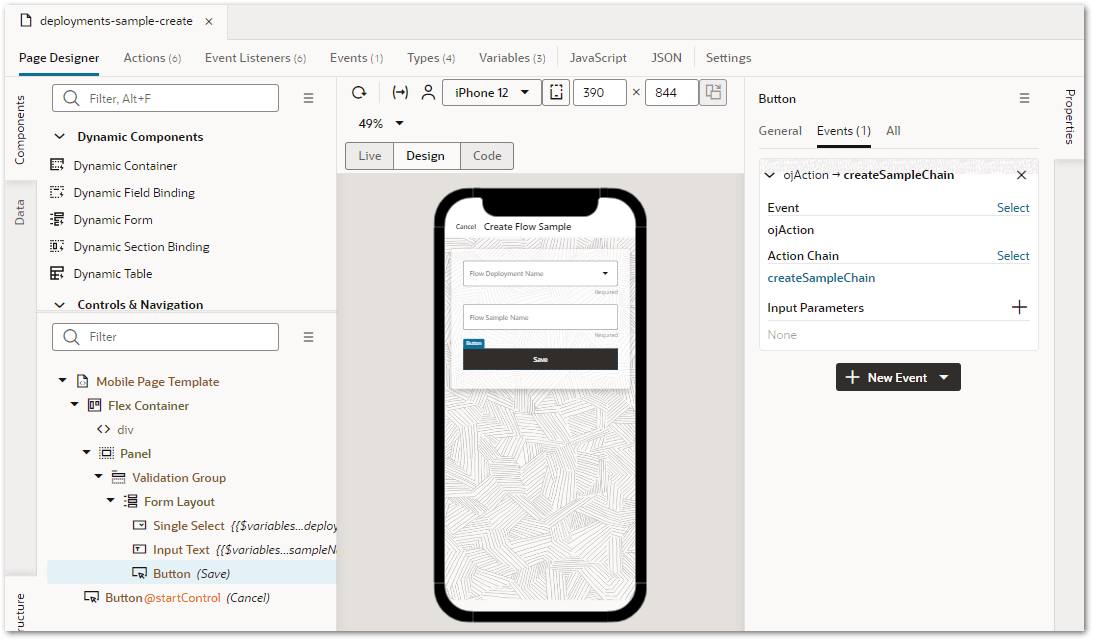

        You could define a similar action chain for a page where the user can create new flows. Here the user could be navigated to the page containing the flow component once the Save button is clicked.
        A button in an Intelligent Advisor flow in Visual Builder used to save the assessment
        The create sample chain action in an Intelligent Advisor flow in Visual Builder

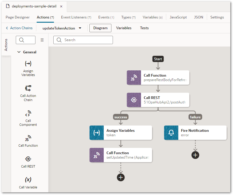

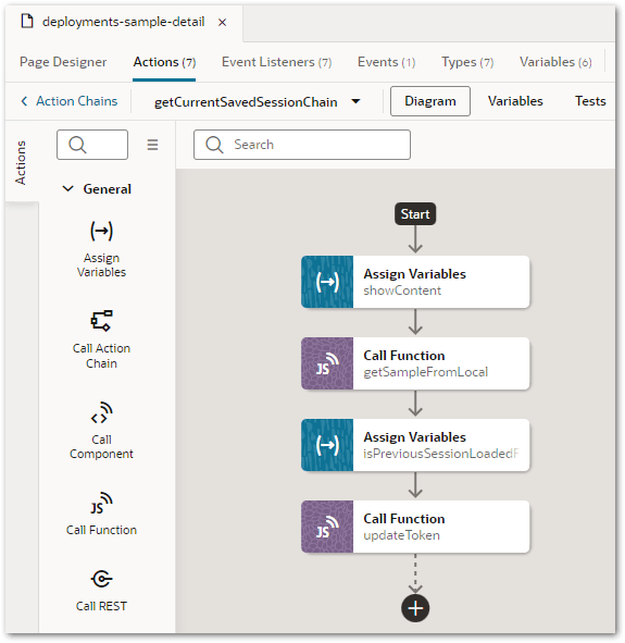

    One way in which an application can set the token property in the flow component is to set it when the user enters the page containing the flow component. Entering the page could trigger a built-in vbEnter listener (for example, getCurrentSavedSessionChain). Inside this action chain, a function could be called to regularly fire an action (for example, collectTokenAction) to renew the token.
    A getCurrentSavedSessionChain action in an Intelligent Advisor flow in a Visual Builder application
    That action could trigger another action (for example, updateTokenAction) which assigns the latest renewed token to the token variable.
    An updateTokenAction action in an Intelligent Advisor flow in a Visual Builder application

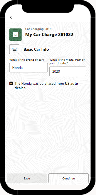

  9. Test the Intelligent Advisor flow in the Visual Builder application. You can do this by clicking the Preview button on the Visual Builder toolbar. The application should open in a new browser window with the Intelligent Advisor flow displaying on the appropriate page.
    A list of Intelligent Advisor flow samples in a Visual Builder mobile application
    An Intelligent Advisor flow in a Visual Builder mobile application
