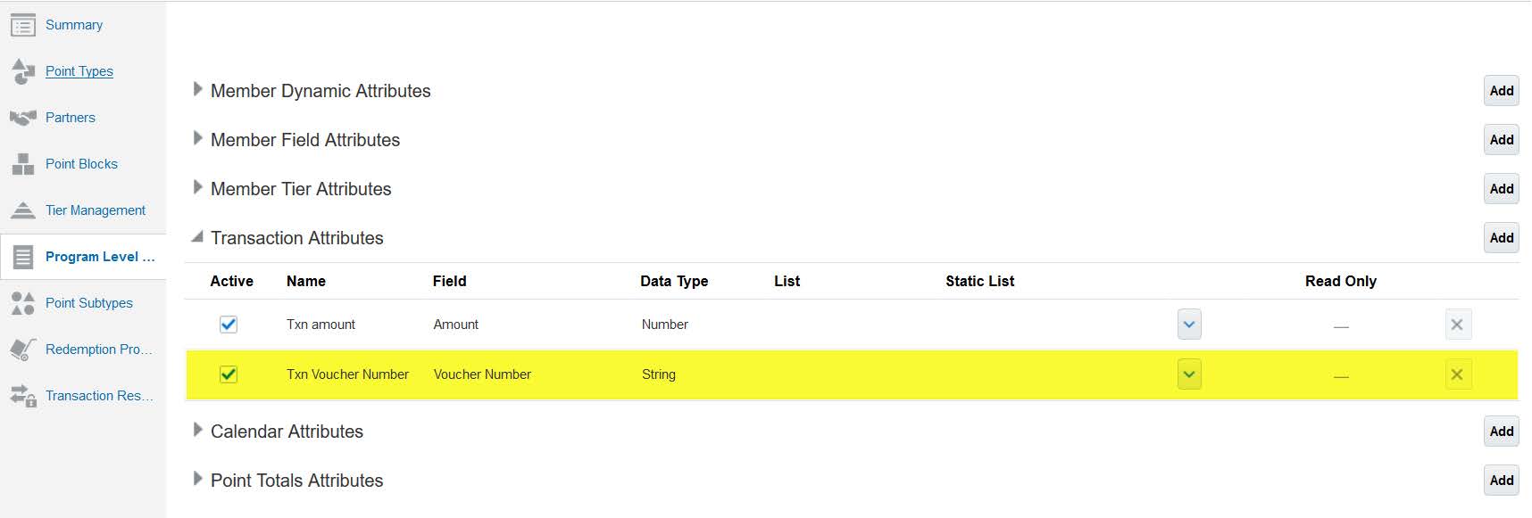

Prerequisite Setup
You must complete the following one-time prerequisite setup in the Oracle Loyalty Cloud UI for the REST call to work:
- Program Level
Attributes Setup. Define the Voucher Number attribute to be used
in Redeem Voucher Action in the UI:

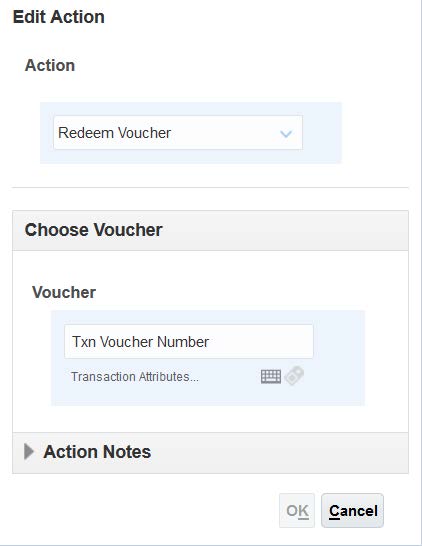

- Redeem Voucher
Action Setup. Define a new action, for example, Redeem Voucher,
in the promotion that applies to any Type or Subtype combination.
You can add the action (Redeem Voucher) to an existing rule or to a new rule under the promotion that is applied to the redemption transaction. Make sure the transaction attribute (for example, Txn Voucher Number) added under the program is selected by clicking the Attribute toggle icon (that is, the mouse symbol) for redeeming a voucher.
The rule could be something similar to:IF [Txn Voucher Number] is not blank THEN DO Redeem Voucher Voucher: [Txn Voucher Number] Notes: "Redeem voucher"
