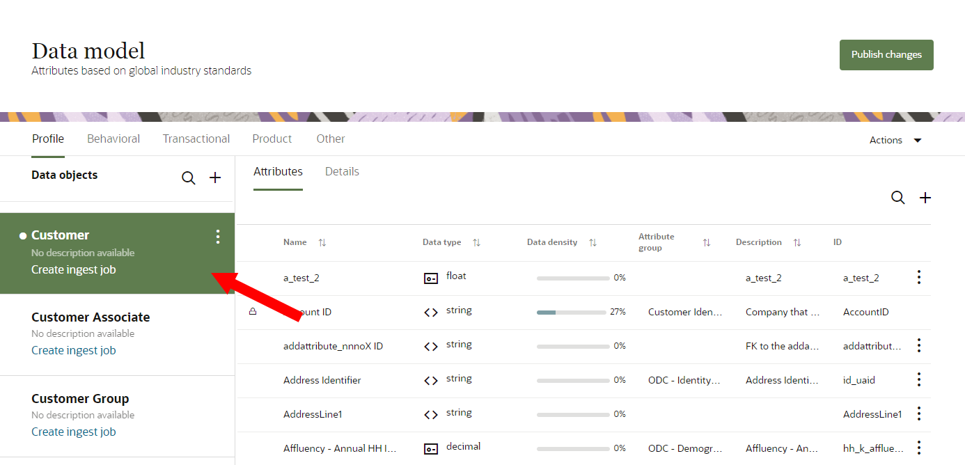

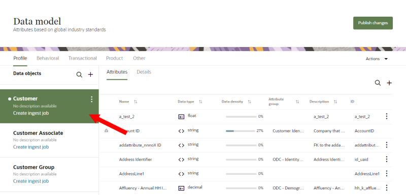

- Select Data model.
- From the list of Data objects, select the data object that stores email address data.

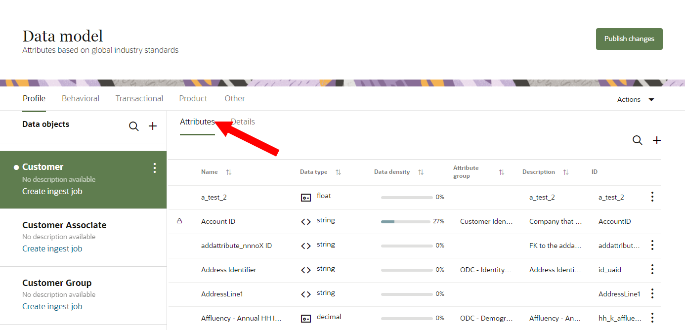

- Click Attributes to see the list of current attributes in the object.

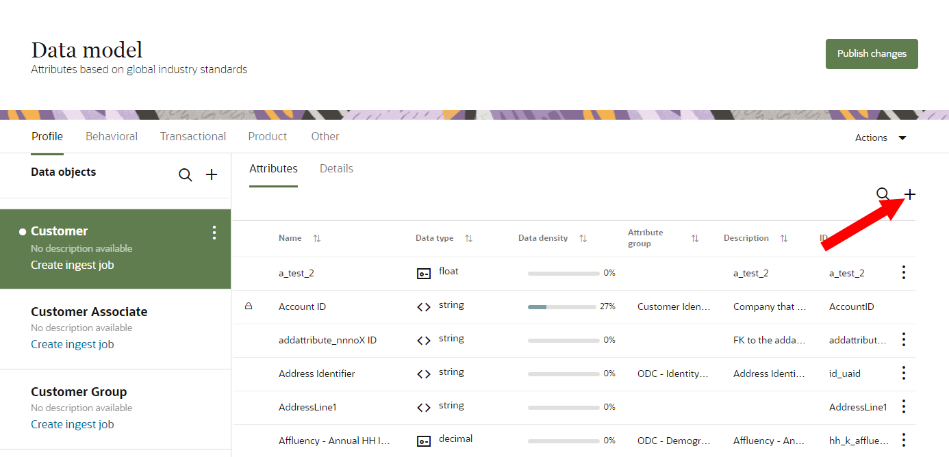

- On the right-hand side, click Add
. The Create attribute dialog will display. - Complete the fields for the new attribute.
- Name: Enter the name HashedEmail.
- Description: Enter a description. This field is optional, but it is highly recommended to add descriptions for any entity created. This helps all other users get additional context when using and navigating Oracle Audience Segmentation. The description can have a maximum of 512 characters with no restrictions on characters used. You can use characters from all languages supported in the language settings.
- Data type: Select string. Learn more about Data types.
- Attribute group: If needed, select or create an attribute group for the attribute. You can change this at any time.
- ID: This is the name used for the database column for this attribute. You can't the ID name after the attribute is published.
- If the attribute name uses English characters, this field is auto-populated from the attribute name you enter but can be changed.
- If the attribute name uses characters from another language supported in the language settings, the ID field will be left blank. You will need to enter a name using English characters.
- The ID must be 1 or more characters, up to a maximum of 50. Use only letters (a–z and A–Z), numbers (0–9), and underscores (_). The first character must be a letter.
- Click Save.
