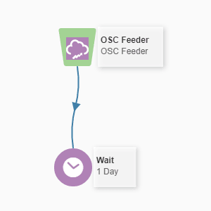

You can use this service on the program canvas. The following example shows a program canvas where the Wait element is configured to run the OSC Feeder step at specific intervals. You can also use the OSC Feeder element with other audience steps on the program canvas to update or create contact records within a program.

  1. Open an existing program or create a new one.
  2. From the Data Sources section, drag the OSC Feeder element onto the canvas.
  3. Configure the Wait element to run at specific intervals and connect it to the OSC Feeder step.

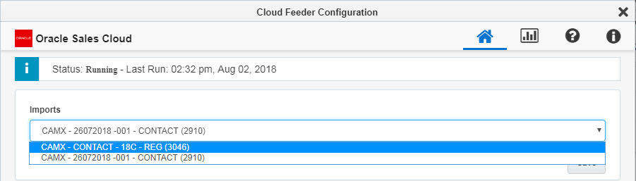

  6. Click the edit icon to configure the action. The configuration dialog provides the option to select an import.
    An image of the Cloud Feeder Configuration dialog.
    Tip: If you are using Firefox and the configuration screen does not load properly, clear the browser cache.
  7. From the Imports list, select the import you want to associate with the OSC Feeder. This creates a link between the canvas and the import.
  8. Click Save to save the configuration and then click Save to save any changes you made to the program.
