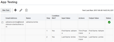

Click Run Test.
The test displays the following results for each contact:
- Step: The step numbers in the order they were processed.
- Condition Met?: Identifies whether the conditions were met for this step with a Yes or No.
- Input Value: The source field value.
- Actions: The list of actions selected in the configuration.
- Output Value: The value written to the destination field after the actions have been processed.
- Status: The test status for each contact. A detailed error message is displayed if the test did not complete or if the contact was not found.
