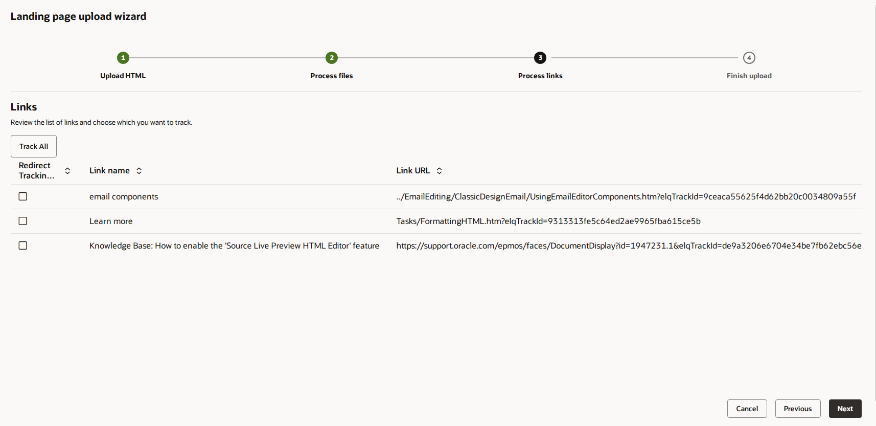

  6. In the Process Links step, all hyperlinks in the uploaded landing page are listed. If you want to track these hyperlinks and ensure that clickthroughs are reported in Eloqua, select the Track Link check box next to each hyperlink. If you wish to track visits to all links in the landing page, click the Track All button in the upper-left hand corner. Repeat as required, then click Next Step.
    An image of the Process Links step.
