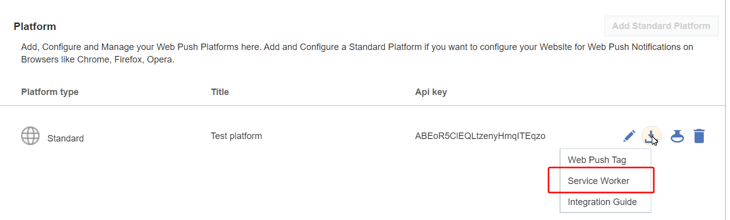

[3.1] Navigate to the App Developer Console and find your Web Push App. You created this in step 1.1.
[3.2] Click Edit > Platform.
[3.3] Click Download > Service Worker.
An image of download option service worker

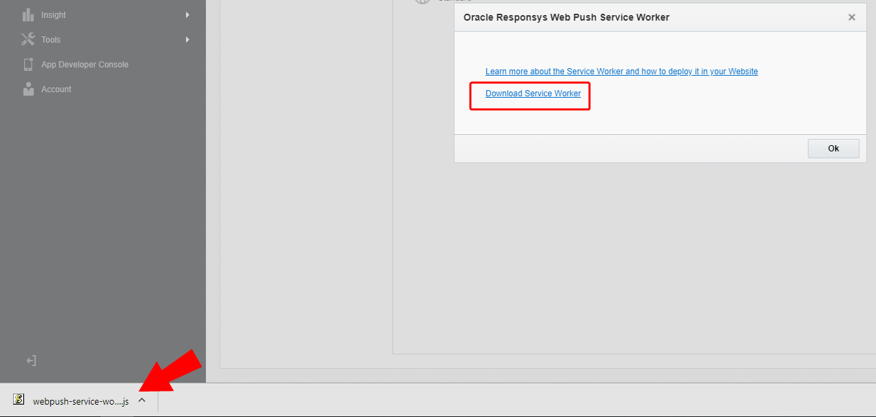

[3.4] Click Download Service Worker. A file named webpush-service-worker.js will be downloaded.
An image of A file downloaded after clicking Download Service Worker

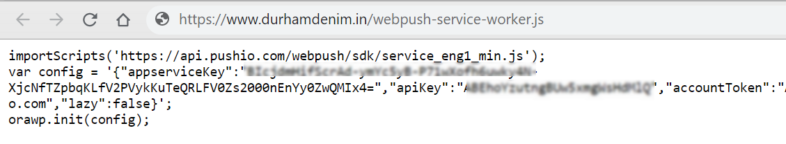

[3.5] Upload the webpush-service-worker.js file to the top-level root of your site directory, making them publicly accessible.
Verify if you've uploaded the Service Worker files correctly by navigating to the file location below (replace yoursite.com with your site's domain).
https://yoursite.com/webpush-service-worker.js
If you've correctly uploaded the Service Worker, navigating to the Service Worker on your site should look something like this:
An image of Screenshot of an example website where the Responsys Web Push Service Worker is implemented
